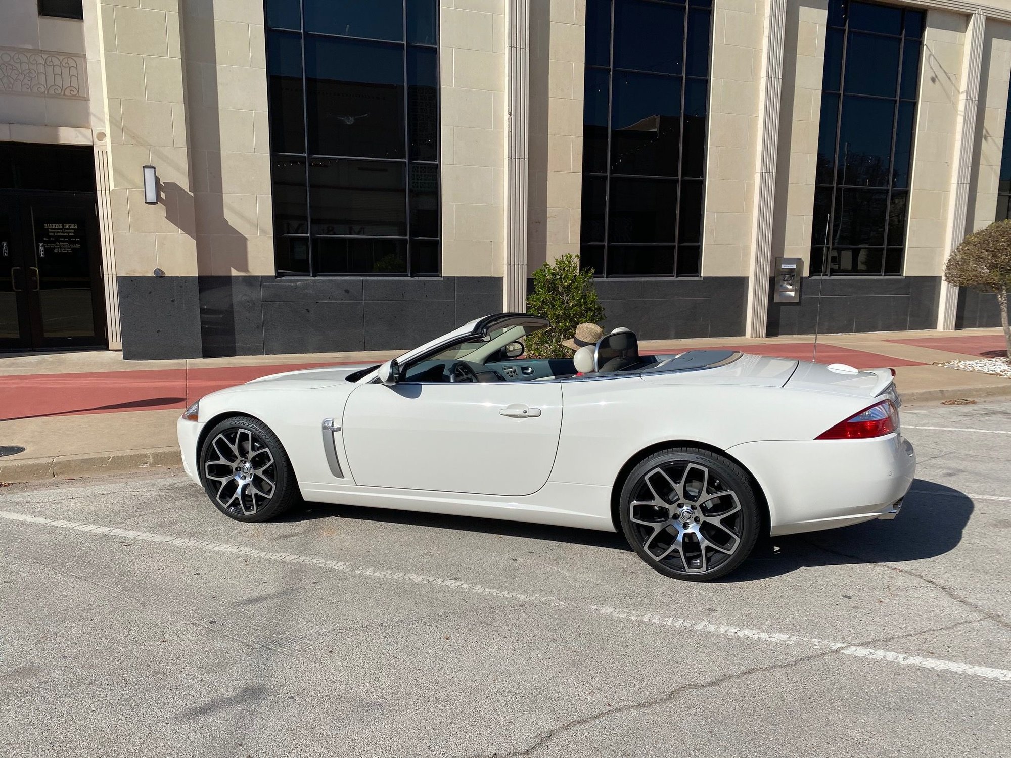

https://www.coventrywheels.com/Jaguar-wheels-rims-whitley/
I have a set of the Whitley’s on my 05 XKR Coupe, they look great.

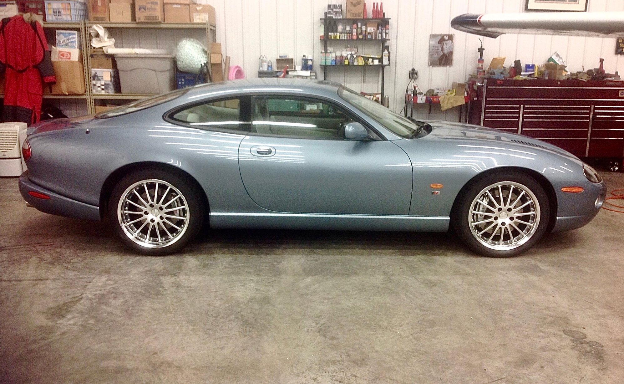

My 05 XKR Coupe as pictured is wearing 295/35ZR19 Continental Extemecontact Sport tires. They fit just fine on the Whitley Hyper Silver 10” wide rims.
Thanks for that, I've done some more research and confirmed that 295s (295/30ZR20) should be OK on the 20" x 10" Whitley.
And sorry about thinking your pictured wheels were the chrome version rather than hypersilver, maybe it was just the really good pic!

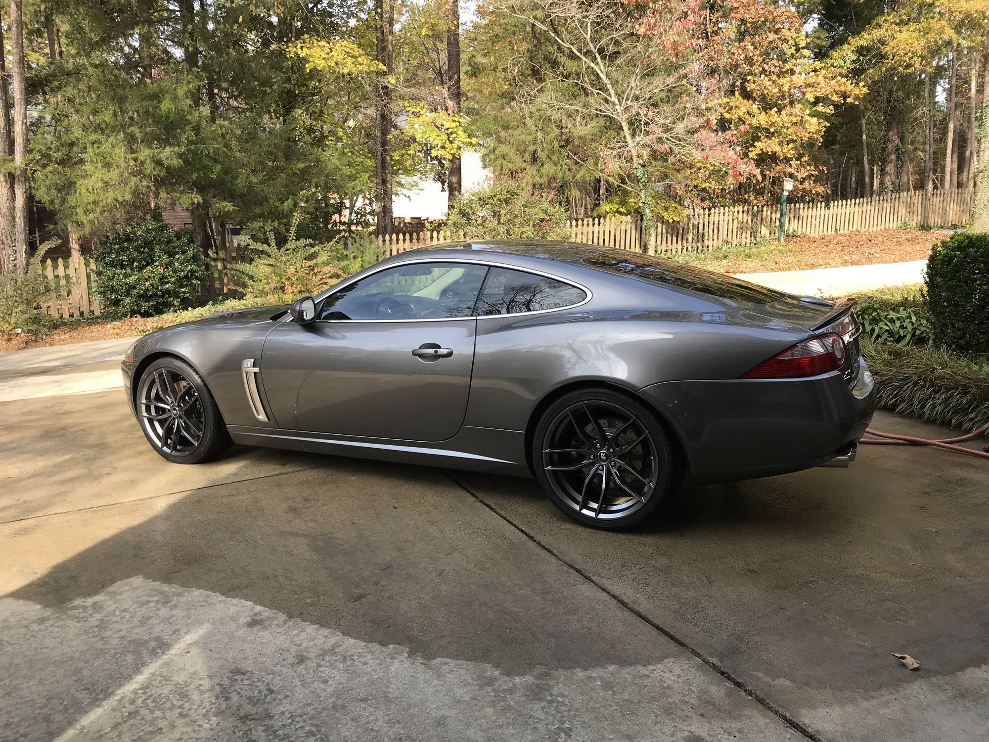

Coventry Ashfords, which are nla.

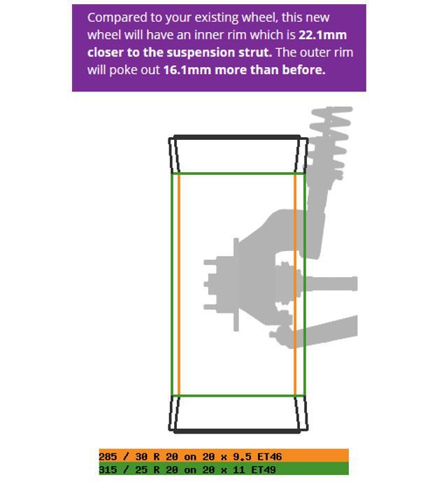

Default How about these? Offsets are 46/49 and width are 8.5 and 9.5
Used forged wheels

for 5l yes perfect fit
Perfect OEM fit.
Perfect fit for the car is a bit different. The OEM rears fit great on the front, especially with the help of a 3mm spacer. Rears can be 11" easy, but need a custom offset. Even 325/30/20s will work
