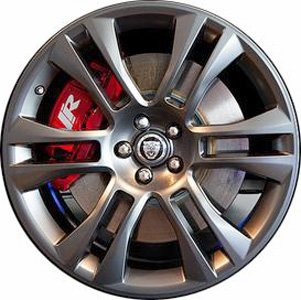

I have a 2007 Jaguar XKR will Part Number: C2P21744, C2P21745 rims fit my car? These are XKRS wheels.
http://www.hubcaphaven.com/mm5/graph...l_59882_lg.jpg
Take a look here. I realize it's a different year but it might help.
https://www.jaguarforums.com/forum/x...widths-137809/
Per the X150 Manual they made a 20" "Vortex" wheel for vin VIN B00379 to VIN B32752 which had the same widths but no mention of offset in the manual.

Not without 20mm spacers, assuming you have the 9.5 width rear rims, your current offset is 26mm, the Vulcans you are looking at are 52mm in the rear. The fronts will fit with no issues however.
