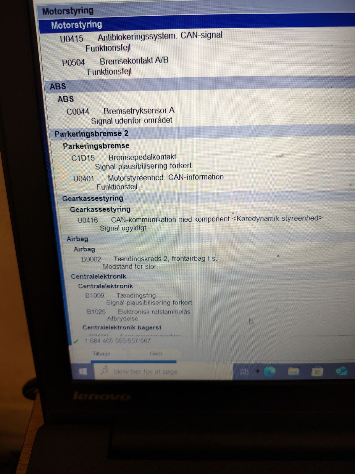

Finally got time of of the hospital to do/ovrlook work/testing done..
1. NOT battery - tried two brand new fully charged from various suppliers(Varta and Bosch)
2. replaced the brakeswitch at the pedal - there were brakelights but.. as a two point/level replaced) no success
tester on and following fault codes came - especially the one about the extreme ABS pressure annoys me.. like it is the ABS module itself and then "sending faults on"
- the one about the Airbag doesnt bother me - :-p
but the rest..
anyone tried these before??
i have been in contact with a well-established Dutch company abotu repairs/control of the ABS unit - sadly i MUST (legal reasons) go through their swedish distrbutor who understands zip.. he has these pics too and started the convo by saying"sorry we do not repair screens" - then oh send unit in when i asked if they had experience with the abs.unit being able to block the car from starting due to extreme pressure internally(10k bar..it shoudl explode with that pressure..) and at the same time giving him these test esults.. then he said he coudl only fix the ABS unit partno below mine and the one above..
Due to my experience in repairing Mercedes/AMG and VW/Audi - my knowledge tells me that when the letters at the end onf the part number changes it is usually the exact same item . but with minor updates - resulting in that these parts can be interchanged - consists of the same components - is this the same with jaguar?
Does anyone know IF it can be the gearstick/shiter incl. box/unit under/attached to the shifter itself that might cause this non-starting (ig.. coudl it be due to the faultcode that it might "think" it is still in gear despite being in neutral and hence will not start??

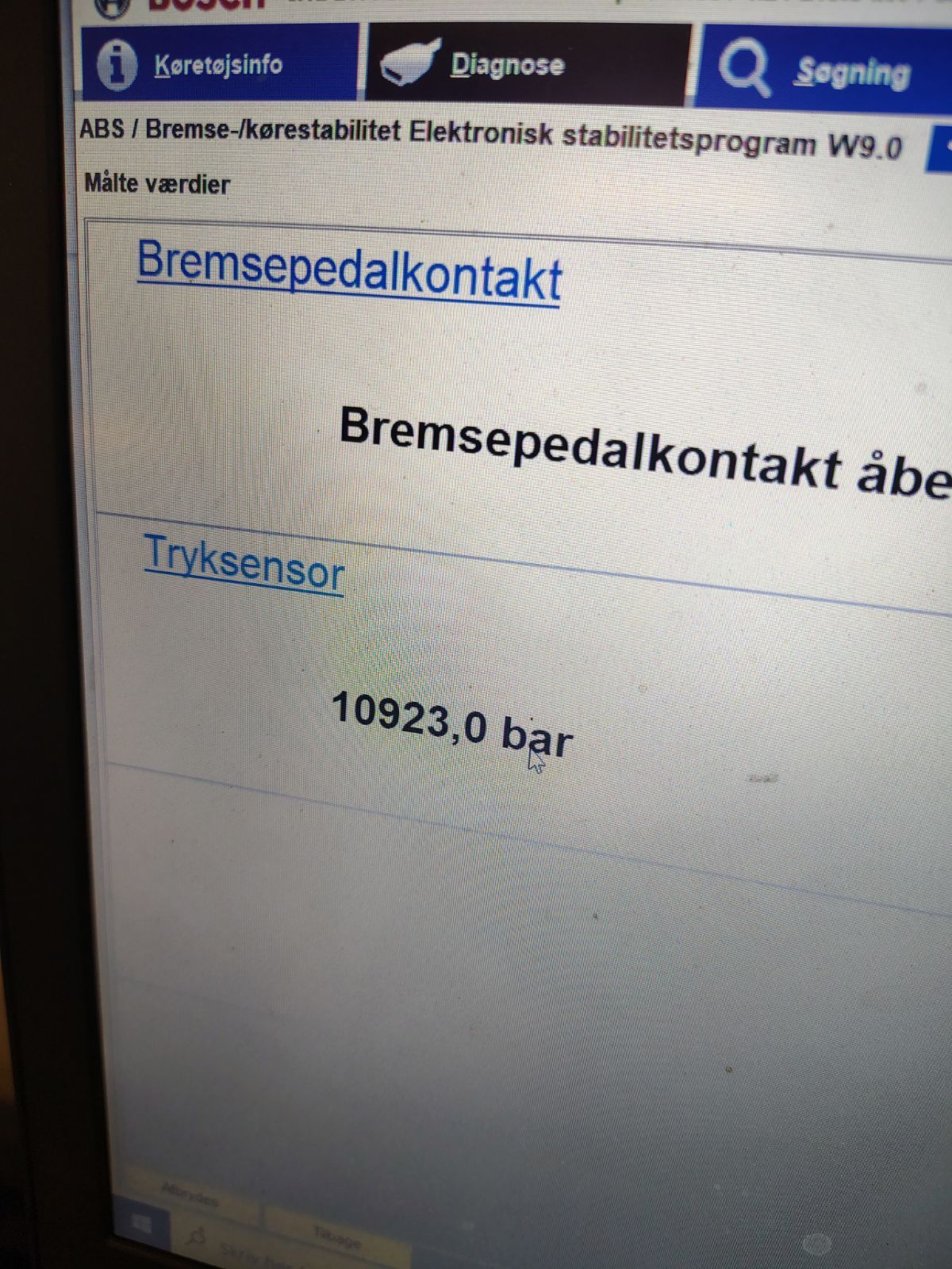

thx.. gearbox should be the same.. on dashscreen it claism to be in gear.. but tester says no.. hence the q
Codes are as follows(same code in English - but here is the description - sorry)
Enginemanagment:
U0415 - ABS . CAN-signal
P0504 - Brakeswitch A/B - function fault (hence i switched the brakeswitch the two step one above the speeder) - but no difference
ABS:
C0044 - brakepedal switch - signal outside area (second pictures says brakepressure is almost 11000bar - which is not possible)(as above - but no difference)
Parking brake 2:
C1D15 - brakepedal switch - signalplausiblesation wrong - no idea what this means... sorry
U0401 - ECU - CAN information - function fault
Transmissioncontrol:
- U0416 - CAN communication with component - "drivingdynamics-controlunit" - signal invalid
AIRBAG - they have been switched off - so will report faults
Centralelectronics:
B1009 - Ignitions - signal-palusiblisation wrong
B1026 - electronic steering coloumlock - closed - but still wroks..
Bremsepedalkontakt = brakepedlswitch - open - but is brand new and measuring on it.. it is as should be ohmwise and closed
Tryksensor = pressuresensor - 10923,0 bar - which is impossible.. it would explode..
so.. ABS-unit creating fault codes all over(DTC-handbrake not engaging- CATS- etc..) or the gearshifter incl. "box" for electronics??
any other ideas?? all is extremly welcome really really want this cat to be driving before i go back "in the doctors house"..
