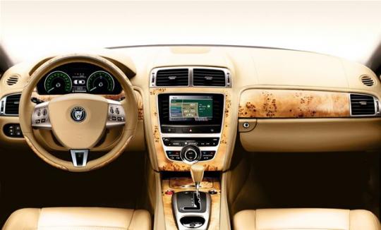

Hi all,
I am going to redo the veneer trim panels in my 2007 XKR.
I decided to use the same pattern as is already in there, but instead of the brown color it will be back-greyish. (see pics of my photoshopped cockpit)
The only problem I am thinking of is removing the wooden parts of the steering wheel. Is it possible to take them off? Has anybody ever done this?
Another option would be to swap the wheel for a full leather version.
Looking forward to your answers!
This is how the car looks now
This is plan A
Plan B incase I can't do the steering wheel..

That blacky-grey color actually looks much better than I thought it would.
Anyway, if you wanted to swap it for the full-leather version, there are several gents in this forum who would probably go for a swap.

Chris,
I prefer the way it looks now. I'd like the grey-black veneer if your upholstery was grey or black. Just my personal taste. Kinda like blonde, brunette or redhead? But since you've already decided to redo the veneer to grey-black, all that matters is that you're happy with that choice.
I noted that your XKR has Adaptive Cruise Control, a rare option (except in 2010, the only year when it was standard equipment). The wood-trimmed steering wheel is also rare, as it was available only in 2007. From your picture, it appears that your XKR is in immaculate condition.
I suspect that the wood veneer on the steering wheel is glued on, possibly with double-sided 3M automotive tape. I'd be very careful when trying to remove it, as you don't want to split that thin veneer or damage the leather. I'd avoid using any solvents and, instead, use a heat gun or hair dryer to soften the adhesive. When softened, slip some monofilament nylon fishing line under that veneer and gradually work it back and forth to remove that veneer in one piece. Keep that veneer warm and take your time. Good luck and let us know if that worked.

@Ranchero50: Yeah me too at first, but it would mean I need to find another steering wheel and take this one off etc.
@Cee Jay: Yeah, I think it looks a bit less retro and a bit fresher. I live in Southern Spain, so it will be difficult to swap with someone in the US.
@Stuart S: Thanks for the tip on the heat gun I didn't think of that yet! I understand what you are saying and obviously it's all very personal, but I find the car looks a bit old with the brown wood, the aluminum finish you see a lot in the XKR's is a bit too much and looks like tinfoil to my taste, but this option looks amazing in my opinion as it go's better with the grey paint used already throughout the car.
My car looks amazing as it is, but this is really a stock picture I used which is a copy of my car. Saved me making a good one I could use to photoshop.
Maybe there are differences in European and US cars delivered in those years, but mine does have heated wood/leather steering wheel and also has a little 'R' sign in the lower part and yes it also has ACC which I find a bit of an annoying feature as it brakes so hard every time you are overtaking on a bending highway...
Perhaps I have a special kind of Edition XKR? Would be nice to know. It was sold to me as a standard 2007 XKR.
@davchr: I will be using aqua printing technique on the old parts after which a layer of coating will go over it. Actually I was told most big brands nowadays make all their veneer like this, and real wood is not being used anymore... This is a lot cheaper. It will look exactly the same when polished as the original one, but in a different color. All at the price of €250,-
Here is a video of the process: http://www.dailymotion.com/cdn/manif...717faa6fc02a62
@amcdonal86: I guess they did in 2007, at least here in Europe. Mine is the same as the steering wheel in the picture but has an 'R' sign in the lower part.

I too had considered going with smoked burl before I settled upon piano black and carbon fiber. My S-type R also had the smoked burl wood and I loved it. I'd highly recommend you reconsider hydro printing due to the end results still looking like fake plastic and also note that high end manufacturers are still using real wood including Jaguar, Rover, Jeep, Mercedes, etc. I understand you are in Spain, but here in Florida there is an ex-pat from Wales who is rather well know for his bespoke and restoration work on Jaguar, Rolls and Bentley - British Auto Wood and he has re-worked the original wood veneer into the smoked look you are after simply by sanding off the polyester coating, bleaching and then re-staining gray. I also do not believe it will be easy to remove the wheel inserts but with the method I described you may not have to. Your other option for the wheel would be to have one custom made, there is a company in Poland that makes them for a very reasonable price.
If you do indeed have the caramel interior I sort of have to agree with Stuart on the color combo, with a black interior no doubt your idea would be stunning, with the caramel, not so sure. Have you looked at the poplar option?
