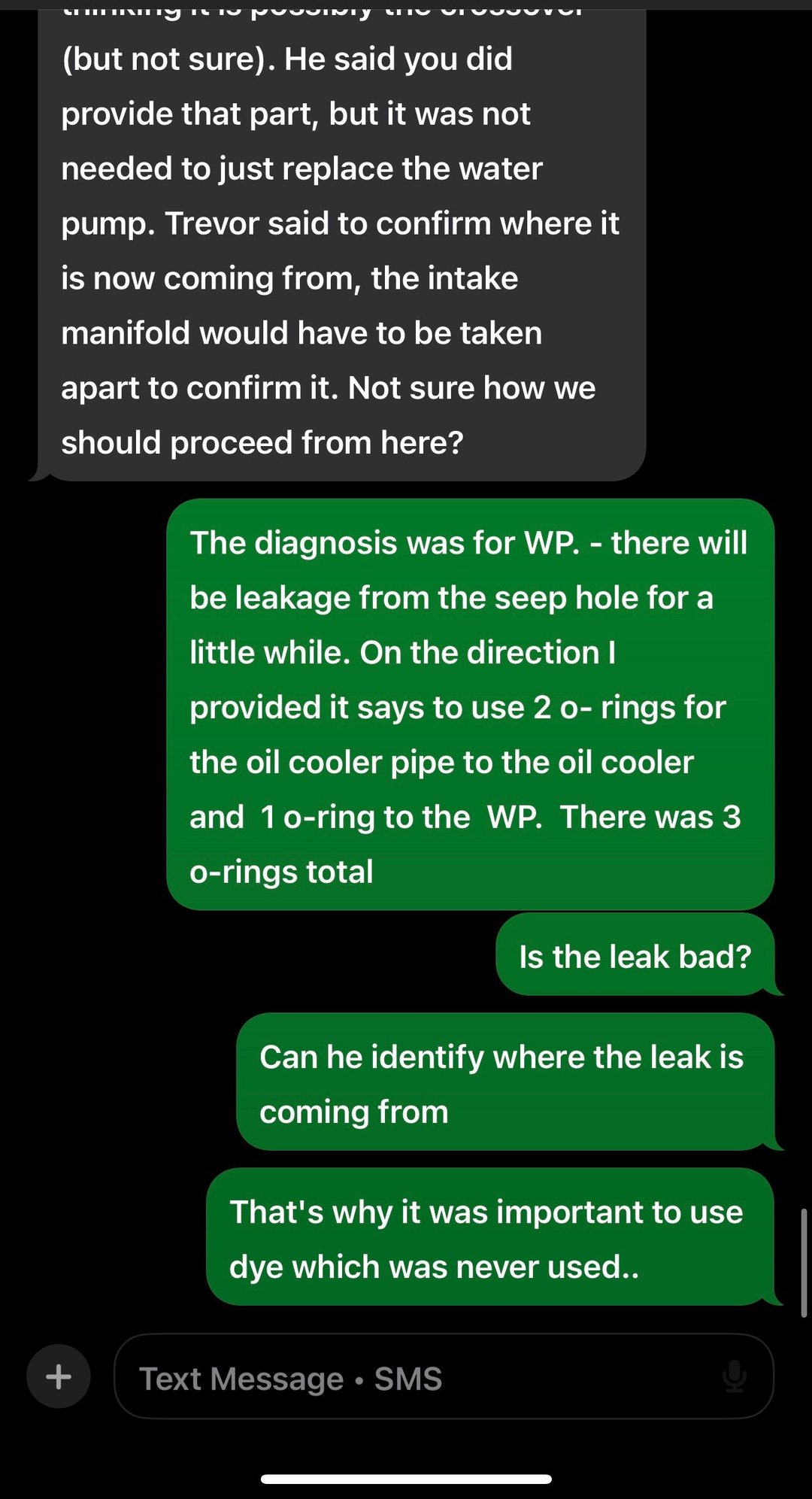

I took my 2011 XK into the garage after it’s been sitting since oct. as I just connected it to the trickle and let it sit starting it once a month.. During a diagnosis I was told that it was the water pump, I was sent a text and they think it may be the crossover flange in the manifold. I have the part already as I come prepared as always.. I even have the 8 oval gaskets to replace. Should they use gasket dressing before setting or just leave them dry?.. Also, should I ask that they apply the 179.50 to the Flange replacement that I still need to approve and what should I accept for labor cost?
They said the leak is coming from the water pump. He was supposed to put 2 gaskets on the oil cooler pipe and connecting to the oil cooler pipe that is between the Water Pump and Manifold. Should I ask that he transfers the 179.50 to the flange replacement? That now needs to be done?

hope all is well with your Cat, the thermostat housing is below the front crossover flange within the manifold.. It would cause persistent leakage behind the oil cooler pipe.. But I will be there Mon. Morning at 7:30 to review the steps taken during the installation process to be sure that 3 o-rings were used in the OC pipe
