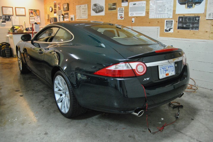

All the symptoms described are related to battery voltage being low - all of them. Replace the battery, and install a CTEK charger , lock the car when not in use and use the CTEK unit when the car is not actually being used. Result? ZERO problems. If the battery voltage drops even a bit you WILL get random issues with seat movement, the top, the windows, warning lights, the touchscreen, etc. In every case the problem is a simple one: low battery voltage. Please believe this....see the photo of my happy, trouble-free 07 resting with the CTEK unit plugged in.
Attached Thumbnails xk arrives...drive it home...now dead batt-xk-british-racing-green-005-small-.jpg
