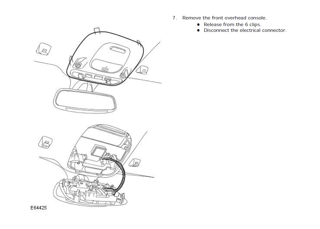

hi there! how to remove overhead console in 2013 xk?

Secured with six plastic tabs pressed into clips:
I can't find an illustration of the clips but Jaguar have used 'V' shaped spring metal clips for similar fixings on many earlier models and the 2013 XK is very likely to be the same. Very sharp teeth on the clips!
