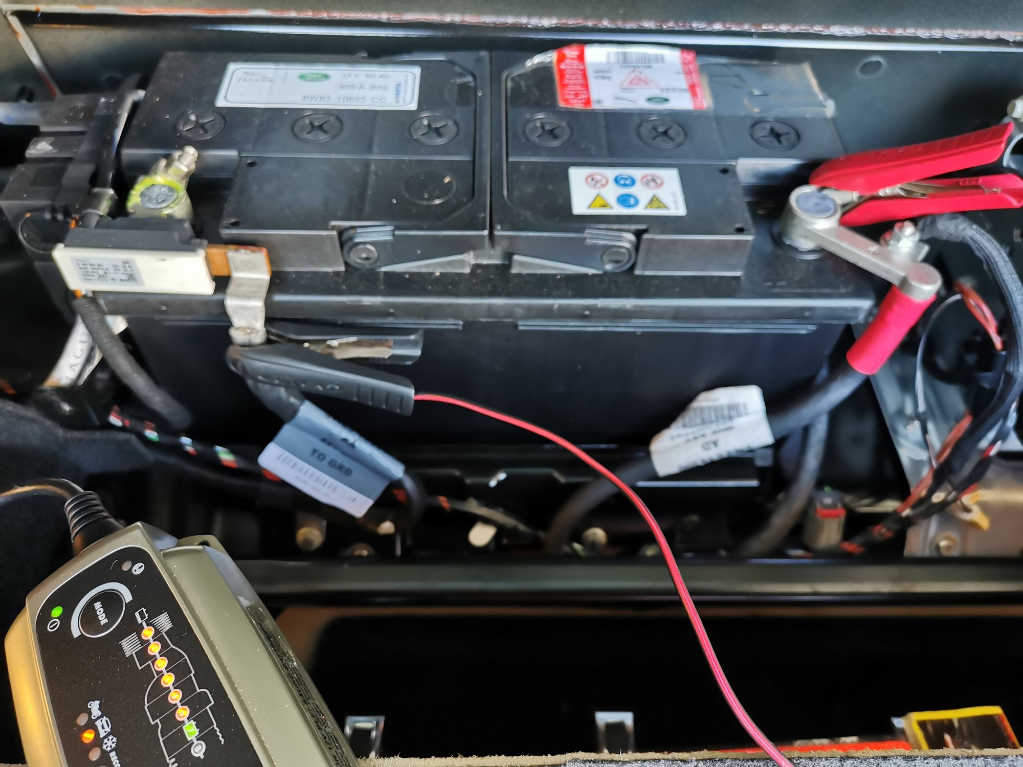

Now I took the following measurements today:
Motor off, Ctek connected for 3 days: 12.36V / 12.42V
Idle cold start 1500 rpm: 13.67V
Idle 1000rpm with light and air conditioning on: 12.44V
Idle 1000rpm without light and air conditioning: 12.5V
Idle 3000rpm with and without air conditioning 12.35V
Then car switched off: 12.47V
I still had half an hour to do something.
Afterwards the battery had 12.7V
Cold start idle 1500 rpm: 13.46V
1000rpm idle: 12.35V
Now I drove the car onto the highway and drove a distance of 50 miles at a speed of around 90 mph with about 3000 rpm and one small traffic jam.
Afterwards I stopped to wash the car. Shortly before the car wash, the screen went black for the first time.
Measured values ​​in the car wash:
Idle: 13.07V
Auto off: 12.5V
After washing the car:
Auto off: 12.36V
Idle: 12.37V
I drove 10 miles home at about 50 mph.
Now the screen went off regularly.
At home:
Idle: 13V-12.8V
Auto off: 12.3V
Now I'm leaving the car in the garage without Ctek and will see about the change in a day or two.

All the measurements you just posted makes me think your battery is terminally toast.

OP. I just took some readings . Battery at rest , car not used for 4 days ,12.59v. Car started and running 14.1 v. Journey of 52 miles , no radio, or climate on , no lights . Battery with car running 14 v. Battery after about 20 mins after shut down 12.67.
Battery is two months young.
I think it's your charging circuit ,your not getting much off your alternator or the circuit.
Also I would put your charging lead on the battery terminal, like you have the positive one.
Final point you battery looks smaller than mine , it may just be the picture.

I'm not thrilled with the values ​​either and will have a stress test done in a workshop.
But the question now is, why is the battery empty?
Is the Cetek defective?
Is the alternator defective and not charging correctly?
Is the BMS defective?
Strangely, the meter shows 13.5V at 1500 rpm. Much less at 1000 and 3000. So it doesn't seem to be loading properly?
With Cetek the battery only shows 12.4V, which is probably too little, but it shows that the battery is full.
Hence the question, why is it not loading correctly?
I'm afraid that if I just replace the battery, the problem will soon recur.
I've already had bad experiences with AGM.
Does it even make sense to install a 100 or 110 Ah battery?

I have now charged the battery again with a new Ctek. With the car turned off with Ctek, the meter showed 13 volts. As soon as I disconnected the charger, the voltage was just under 12.4 volts.
Therefore it definitely looks like the battery is at its end.
But that doesn't solve the question of what its the reason for it.
I'm going to buy a new battery and have the alternator checked at service next spring. I can't think of anything else right now.
What do you think about installing a 110AH battery instead of a 90AH battery? (Lead acid, no AGM)
