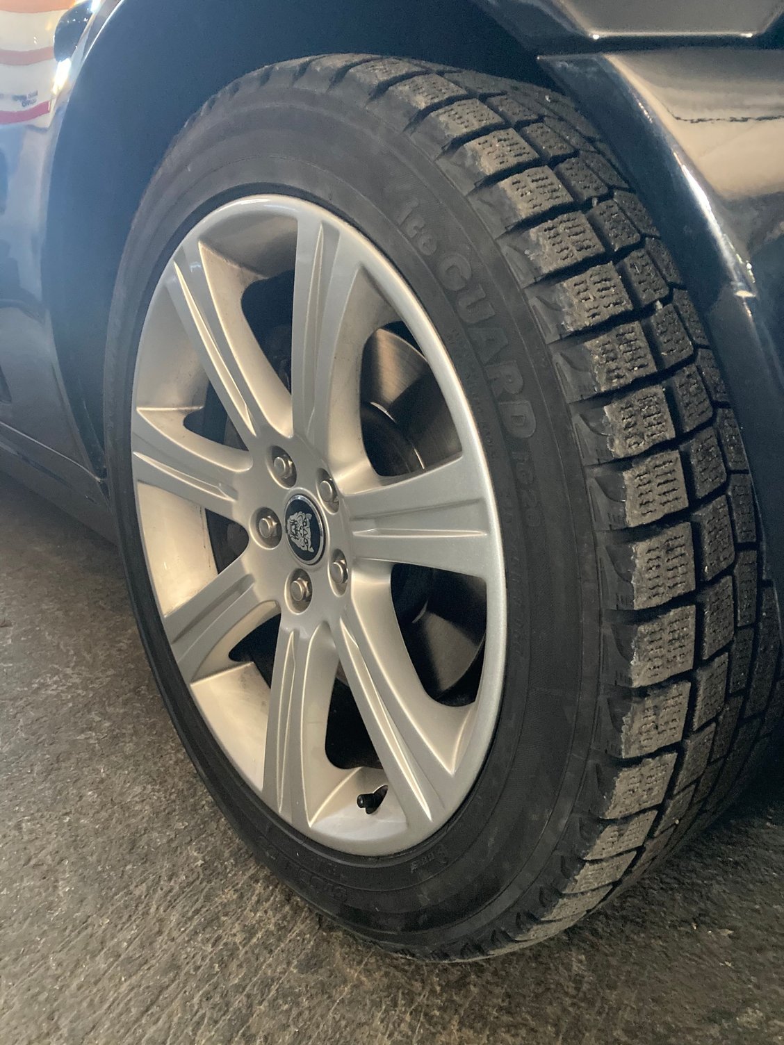

I use non staggered 18’s. Actually, the rims are the winters from the xjr.
Your thinking is accurate, under aggression, the wider profile in the rear promotes instability and hydroplaning.
Get the most aggressive winters you can afford. You won’t be disappointed. Car handles like a dream.
