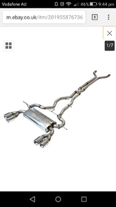

Anyone had an experience with this company the craftsmanship looks to be of substantial quality and it comes in at a very reasonable price.
Going off the pics it looks to be the quad tipped rear box and mid pipe with x-pipe

Know nothing about them, but remember those pipes are bent for a 5.0 car, your 4.2 is a bit different.

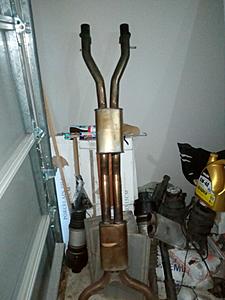

What I was trying to say, is that if you look at the picture you posted, the pipes from the x-pipe to the muffler box are not mirror images of each other. The left pipe has a large bend in it, I think to get around the ediff. Your 4.2 pipes are much straighter, and close to mirror images of each other.

Going off a few pics 4.2 vs 5.0 it appears the hangers on the actual mid pipe section would have to be relocated so an exhaust designed for a 5.0 could fit the 4.2 mounting brackets , apart from that I can't see any further issues .

Maybe these images will help show what I was describing for the difference in the exhaust piping for the 4.2 and 5.0 cars.
This is a back box from a 4.2L, note how close and mirror image the pipes are at the top of the photo.
This is a back box from a 5.0L, note how different the pipes are at the top of the photo.

Kj I understand what your saying however the top gear exhaust comes with a new rear box and mid pipe so whether there is a bend in the muffler it won't make a difference

I wonder if that inlet pipe kick isn't to clear something for the E diff?
I also think it's a pity that they don't have some video clips and decibel readings for their exhaust vs. stock. Throwing a lot of money after a couple crappy pictures...
