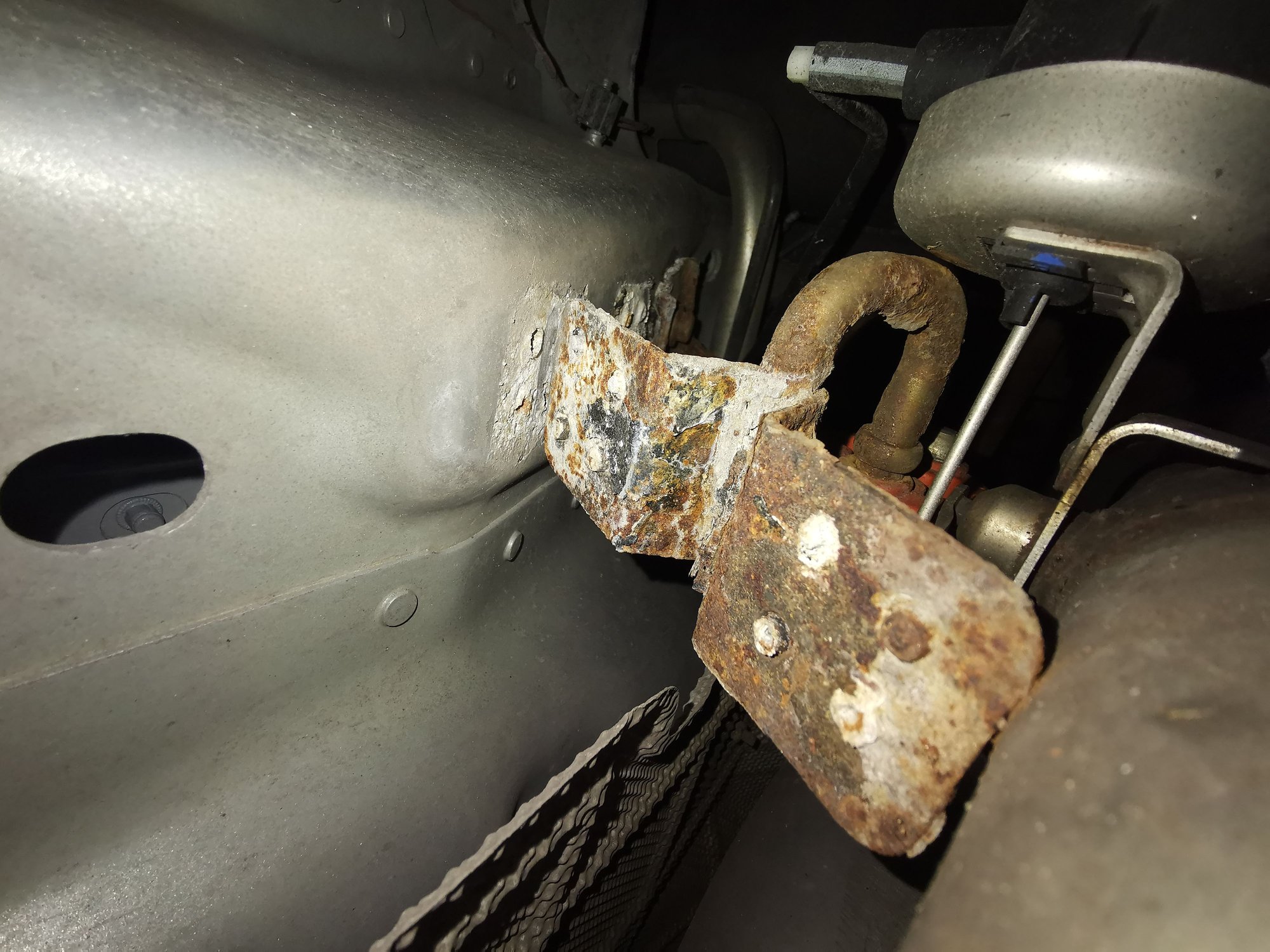

Had a rattle for the past month or so, definitely coming from under the car. visual inspection could see central heat shield was hanging low, needed replacing. Had that done at a Jaguar garage today, they checked the other heat shields and applied the 'large washer' fix where necessary. Annoyingly still had a rattle when driving back, had dreaded thoughts of a ruined catalytic converter or something expensive. Got back under the car, looked at exhaust mounts this time. Easy spot, the rear back box exhaust mount which is affixed to the body of the car has come off, through corrosion, other one is likely soon to follow. Haven't 100% confirmed this as the source of noise but fairly confident as its chunky metal plate thats going to be hitting the exhaust when going over rough road/bumps.
Right rear exhaust box mount
Left rear exhaust box mount
Had a quick look on the jaguar parts website, cant find the item in exhaust parts or external fixings, can anyone identify? Also if anyones had this issue and can chime in with suggestions, would be appreciated. Looks like the bolts/studs are still in the body of the car, so that might cause issues. I imagine no welding as its aluminium tub?
Thanks

They look like rivets which have snapped, maybe drill them out & replace with self tapping bolts

Originally Posted by MarkyUK
Any halfway decent exhaust place should be able to prefab sommat at reasonable cost, it's their bread and butter after all.
Yeah thought so, more worried about getting the old fixings out and attaching the new one.
Originally Posted by JackJohn
Strange the Jaguar garage didn't mention this problem to you. It is their bread and butter also.
Didnt ask them to find the rattle, but considering they were replacing the centre heat shield which requires dropping the exhaust you'd think they would've spotted it!
I have the broken one with me and the fixings seem smooth on the other side so looks like rivets. Id rather not tap into that lovely aluminium tub, could just rivet it again after removal and cleanup? Maybe use stainless rivets and bracket this time?
I’d think about using aluminum parts, or at least try to put something nonmetallic between the steel and aluminum to reduce galvanic corrosion.
....................I have the broken one with me and the fixings seem smooth on the other side so looks like rivets. Id rather not tap into that lovely aluminium tub, could just rivet it again after removal and cleanup? Maybe use stainless rivets and bracket this time?
Yeah, that's what I'd do, use rivets. Screws tend to tear out. Also, maybe use regular aluminum rivets with stainless brackets.

Originally Posted by guy
Don’t know about that. Look up galvanic corrosion. I would never mix stainless and aluminum. A lesson learned from my boat.
Better stainless than the raw steel Jag used in the first place.........
I was assuming you can't access behind it to use rivets, keep us updated on how you get on
Blind rivets were invented for the situation when you can’t access the backside of the joint. They come in a variety of materials for galvanic compatibility.

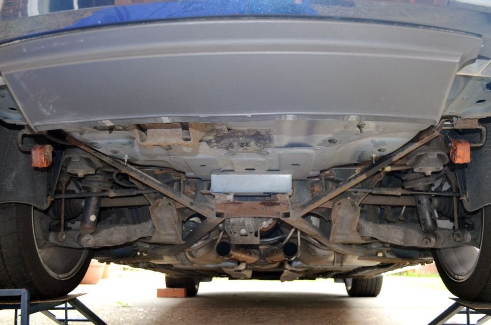

Considering this is what comes off to replace the centre heatshield, the garage can hardly have been unaware one of the rear hanger brackets was broken:
I was also replacing the rear heatshield at the same time when this photo was taken because it had been rattling against the top of the rear silencer.
Old Mar 23, 2022 | 09:56 AM
Alster370's Avatar
Joined: May 2017
Posts: 120
Likes: 43
From: United Kingdom
Definitely agree there. Local independent quoted £168 to refurb, paint and re rivet both brackets, seems reasonable enough. Will post back here with results.
