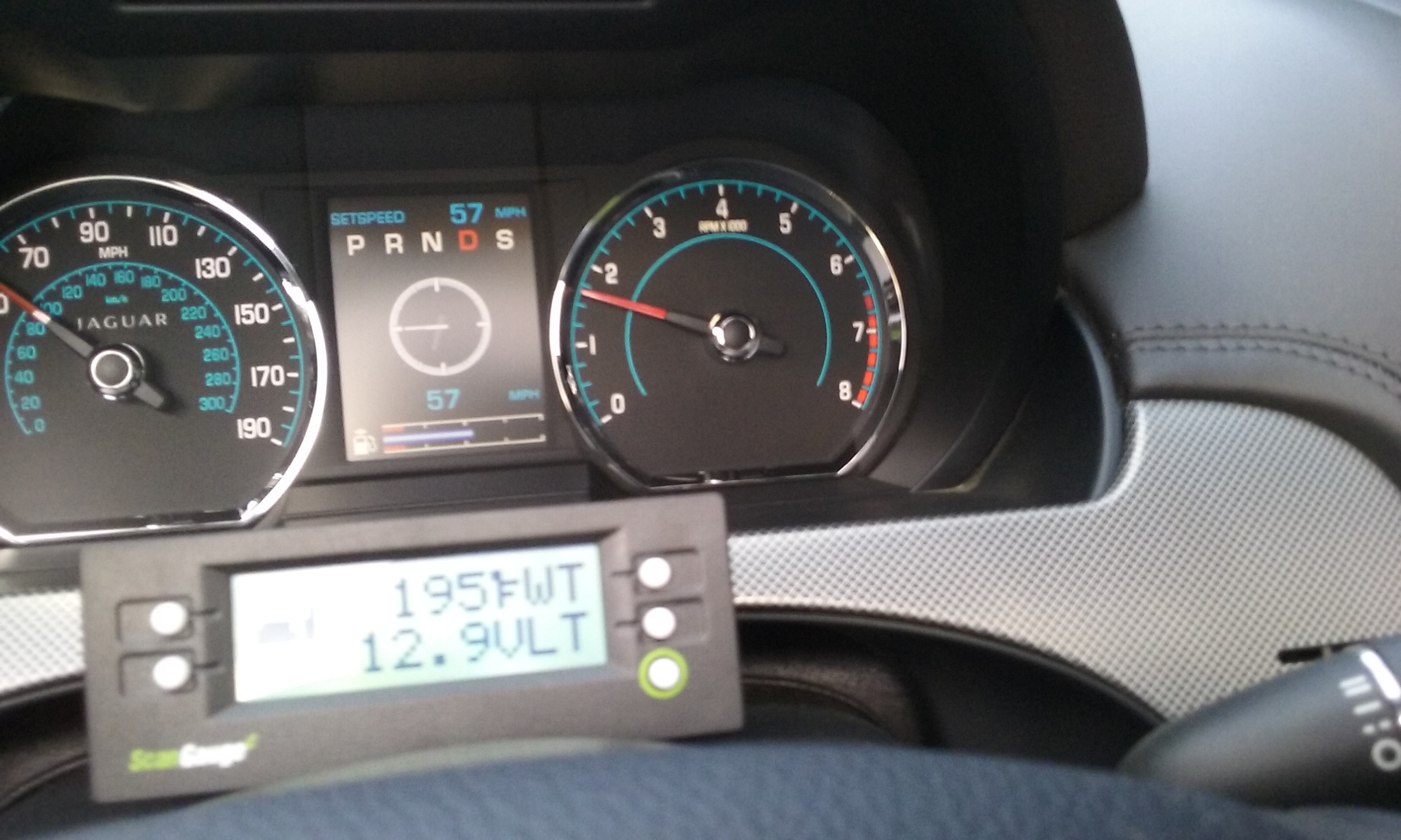

As for the easy temp meter, I will, from now on, use as a routine my phone and a small wireless OBDII sender unit and e.g. the "Torque" app via Bluetooth. (I have an unneeded small and neat looking smartphone, I'll just fix that in driver's sight, then I don't even have to open the app on my main phone. Only issue is how to automate or if there is a neat unit available to read the data.)

Assuming you find and fix the leak, then do a careful road test. Best if you have an OBD II reader that will read coolant temp. If temp starts to rise well above normal, stop car and check for a stuck-shut thermostat. To check merely hold your hand over the thermostat. Not necessary to actually touch - close enough to feel the heat will do. Then do the same over any portion of the radiator. If the radiator is comparatively cold, your thermostat is likely stuck closed.

How to build a temp alarm
Originally Posted by GaryTheViking
"My XKRS blew all coolant after bursting a plastic part, all in a few minutes after first light came on. So watch the coolant temp, as there's no early warning indication."
Here is an elegant way to do it, thank you Aonsaithya:
For this very purpose I have an OBDII bluetooth scanner fitted permanently to the port via an extension cable, on which I've cut the power wire and substituted it with a fuse tap. That way the scanner is on only when the car is on, and won't keep draining the battery. On my phone, I have YouBlue set up to start Torque Pro when the scanner is detected, and Torque has an alert set at 100°C / 212°F coolant temp. This way I have essentially automatic logging & alerts whenever the car is running.
