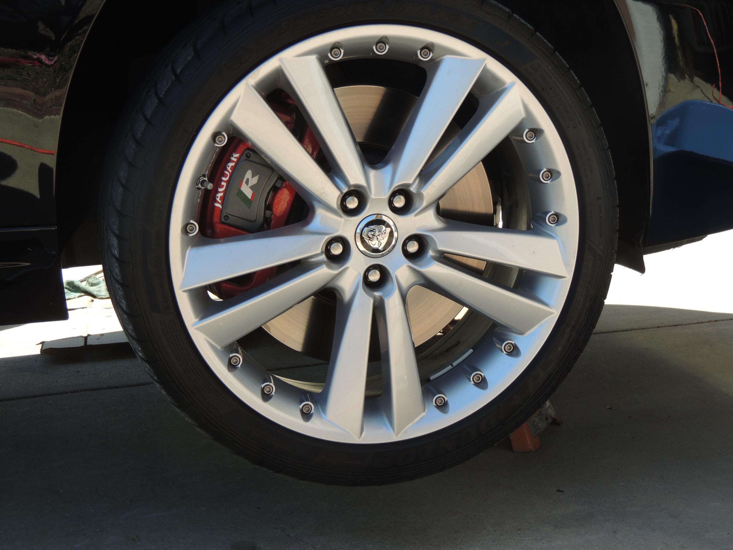

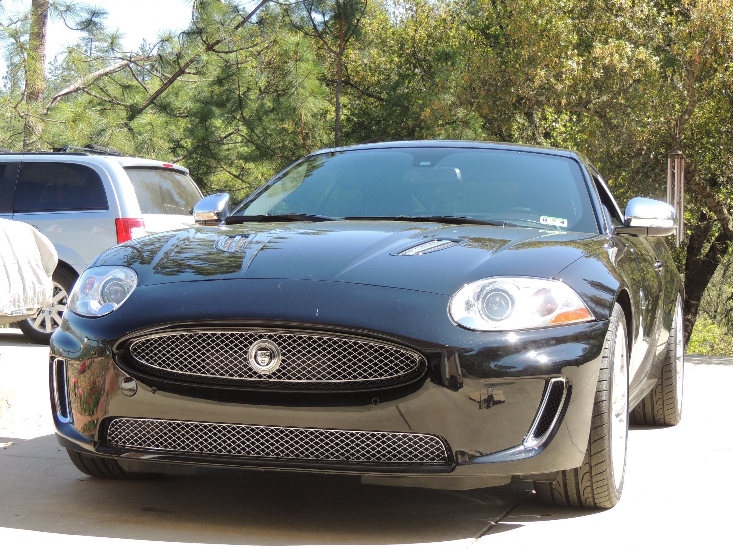

I’ve just finished working on my car for today, having painted my brake calipers and installed 20mm front spacers and 15mm rear spacers. During the test drive I could definitely tell the extra 40/30 mm track width while cornering. I made sure that I washed up nicely and changed into clean clothing before taking that test drive. Then, just yards from my driveway a young woman flagged me down, telling me that her horse had just thrown her. The horse ran away. I looked at her condition (no bleeding) but plenty filthy for landing in some muck and was ready to recommend that she kept walking (my sense of helpfulness only goes so far…) She must have read my mind as she yanked the door open and threw herself into the passenger seat of my ultra-clean XKR with whites stitching on the seat, muck and all, demanding that we go horse-hunting in a Jaguar…. We did find her horse about a mile up the road, she exited without thanks and my car needed some serious interior cleaning. Lessons learned…. &$%#&????
Edit: Pictures show painted front calipers and car with 20mm front and 15mm rear wheel spacers.
