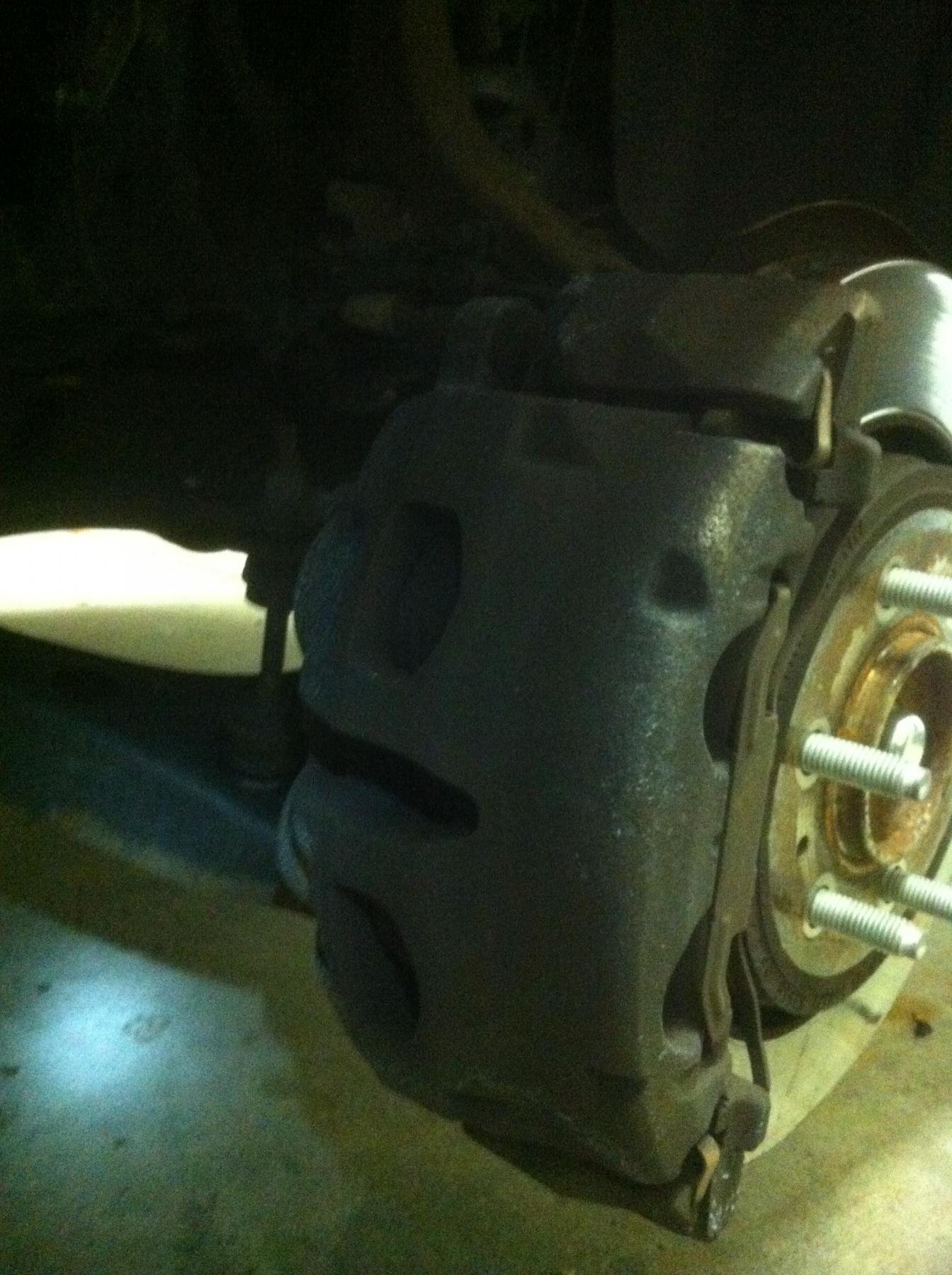

Hello gentlemen,
I was rotating the tires on our 2009 Lincoln Navigator and the brakes caught my attention. I think they are the same brakes (calipers, pads) that is on the XKRS.
I have snapped some pictures. I know Jaguars still have lot of Ford parts integrated into them.
What are your thoughts?
I couldn't find a good picture of the XKRS brakes, but you guys with the car would probably know.

WOW yeah that looks like em 2 piston sliding calipers. I can see a few slight differences but they are close. Same brakes on the XKR as well.
I don't have a picture with the wheel off but here is one for comparison.

I was really taken by a surprise as the whole configuration is very similar. They are sliding/floating calipers. The pad placement is exactly the same and on the back of the caliper has the little plastic covers like the Jaguars do.
We have had lot of trucks in our household and the Navigator has the best brakes out of all of them. It stops really well.
The collaboration between the two companies is very significant it seems.

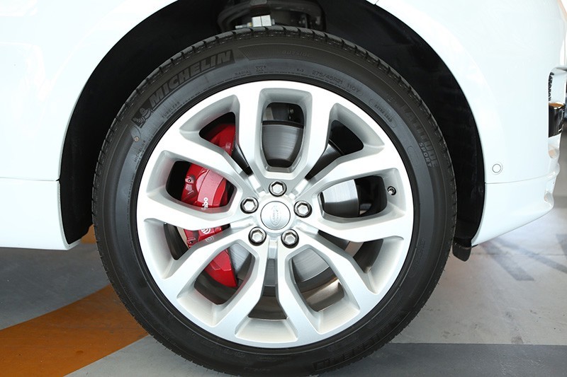

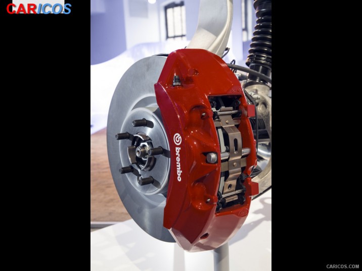

The last Jaguar with Brembos was the 05 STR. Then in 06 they switched to regular Jaguar brakes, which I have heard were Brembos.
The new Range Rover has Brembos as well as they advertise it on Land Rover's website. I will see if I can get a picture of it to see if it's floating caliper or not.
Looks like it's fixed.

It looks fixed but I don't see the transfer tube for the opposing pistons or bleeder valve.
Just looked around the net and Brembo does make some sliding OEM calipers. Learned something new today.
