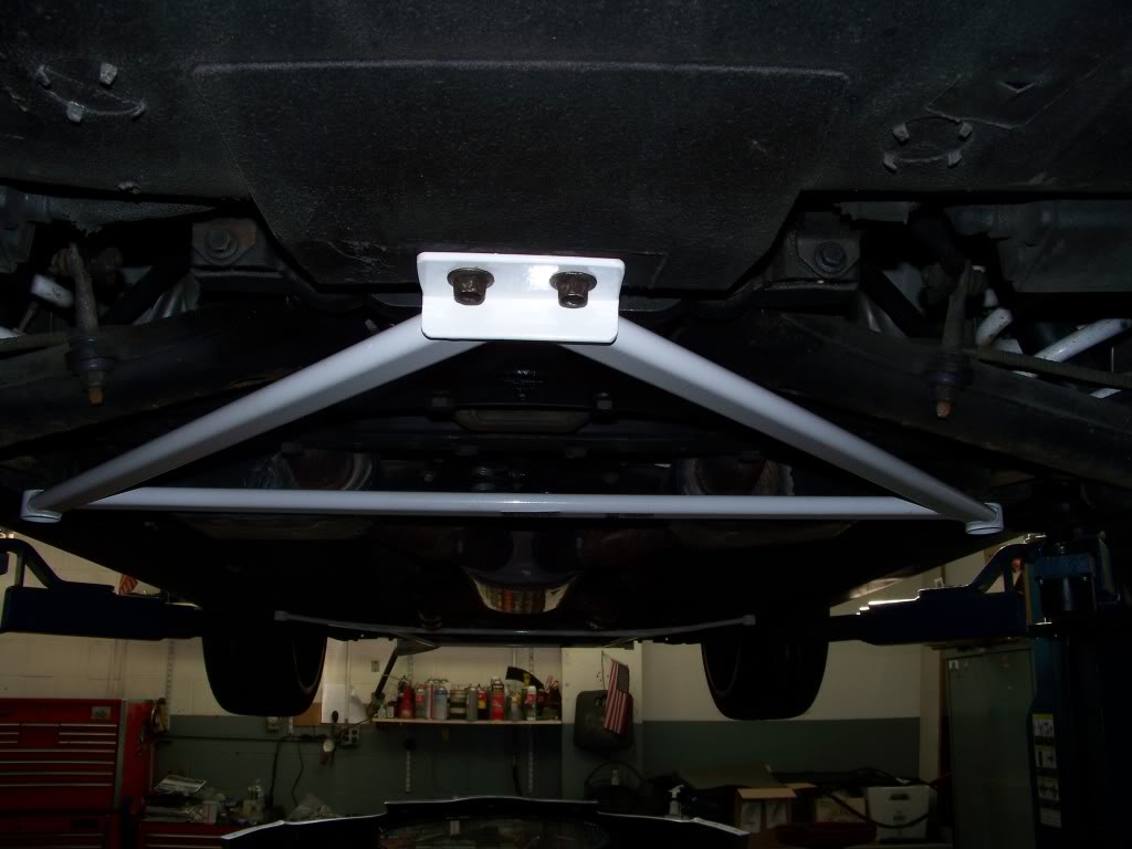

If you go with all poly bushings you get the end link bushings in the kit.
Attached Thumbnails 12 year old coupe, 95k miles too old for upgrades?-001.jpg

Any scraping issues with the lower frame braces?

More importantly - any noticeable difference in handling?
