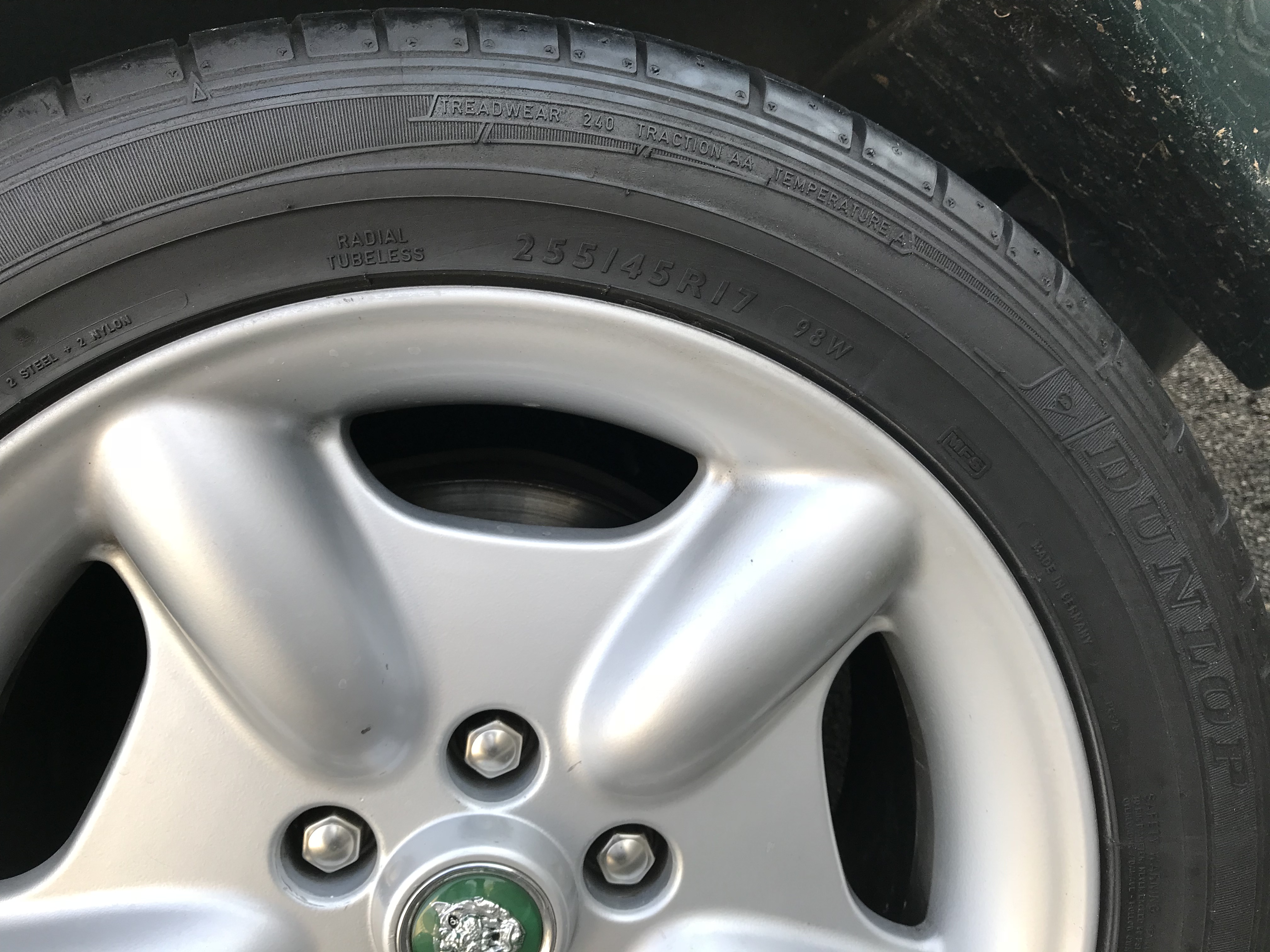

Its time for new tires to go on my 17 inch lamina wheels. I am thinking of going to 235/55 or 255/50 size tires. Anyone running these sizes I would like to hear your comments.
255/45R17, better look and better ride.

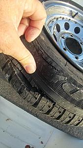

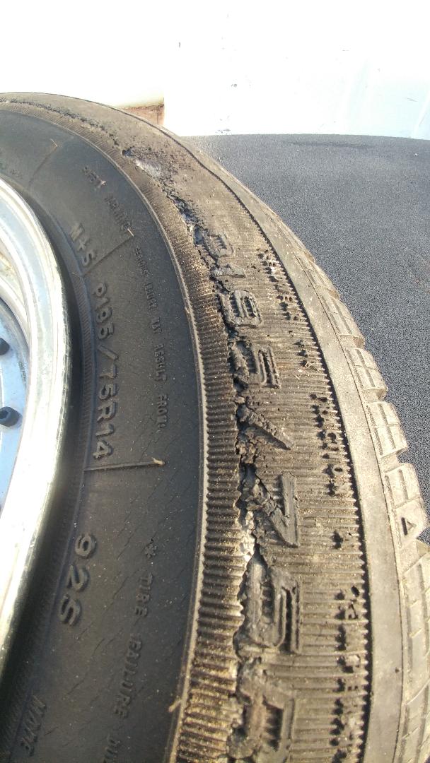

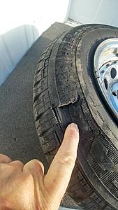

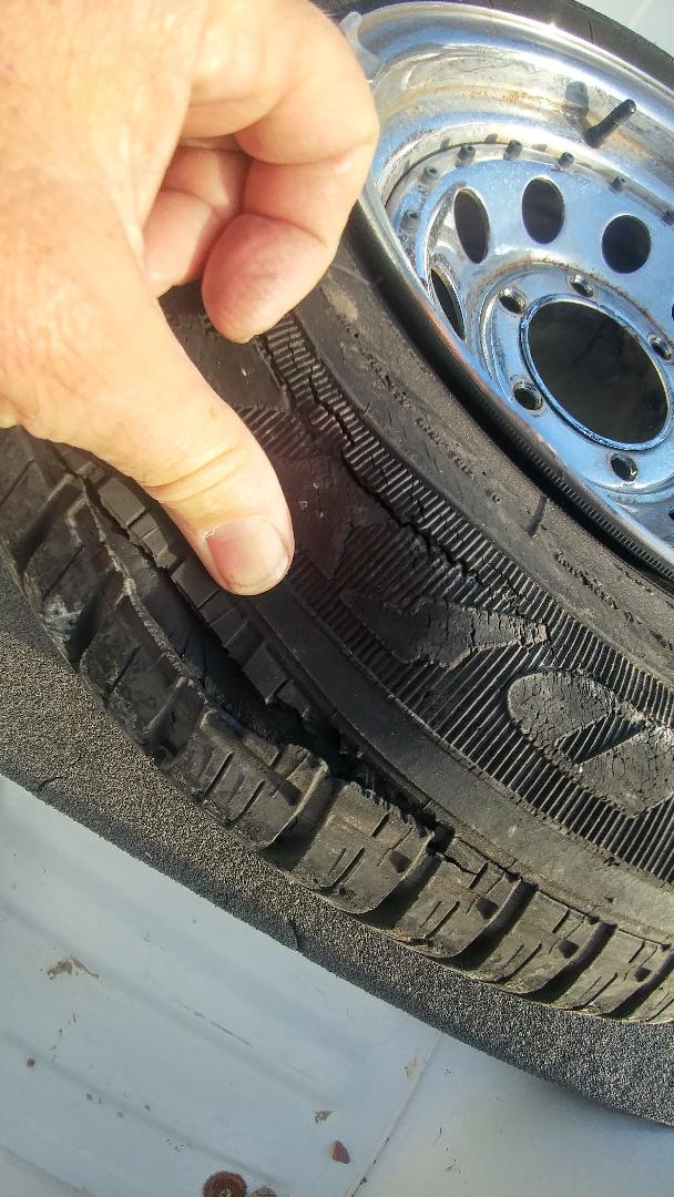

What else? A tire with a longer mileage warranty utilizes harder rubber compounds, resulting in a trade off between ride comfort and longevity. If you don't drive the car very much, consider a lesser expensive, lesser-warrantied, softer rubber tire, as you run the risk of reaching the 6-10 years of life expectancy without getting the value out of the tires. Sadly, I just had to replace all four name-brand tires on my 1994 Nissan pickup truck that has only 52,000 miles on it. The tires had 9/32's of tread left and only 2,000 miles of driving, but were 8 years old and had dry-rotted to the extent that two of them literally collapsed just driving it to the gas station. Of course, I live in the desert, so your results may vary.
