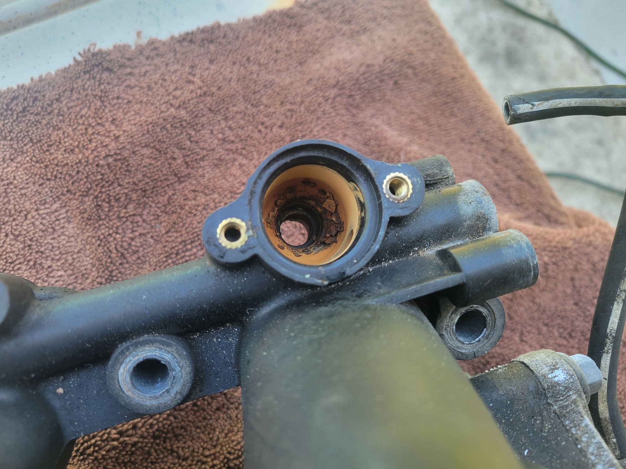

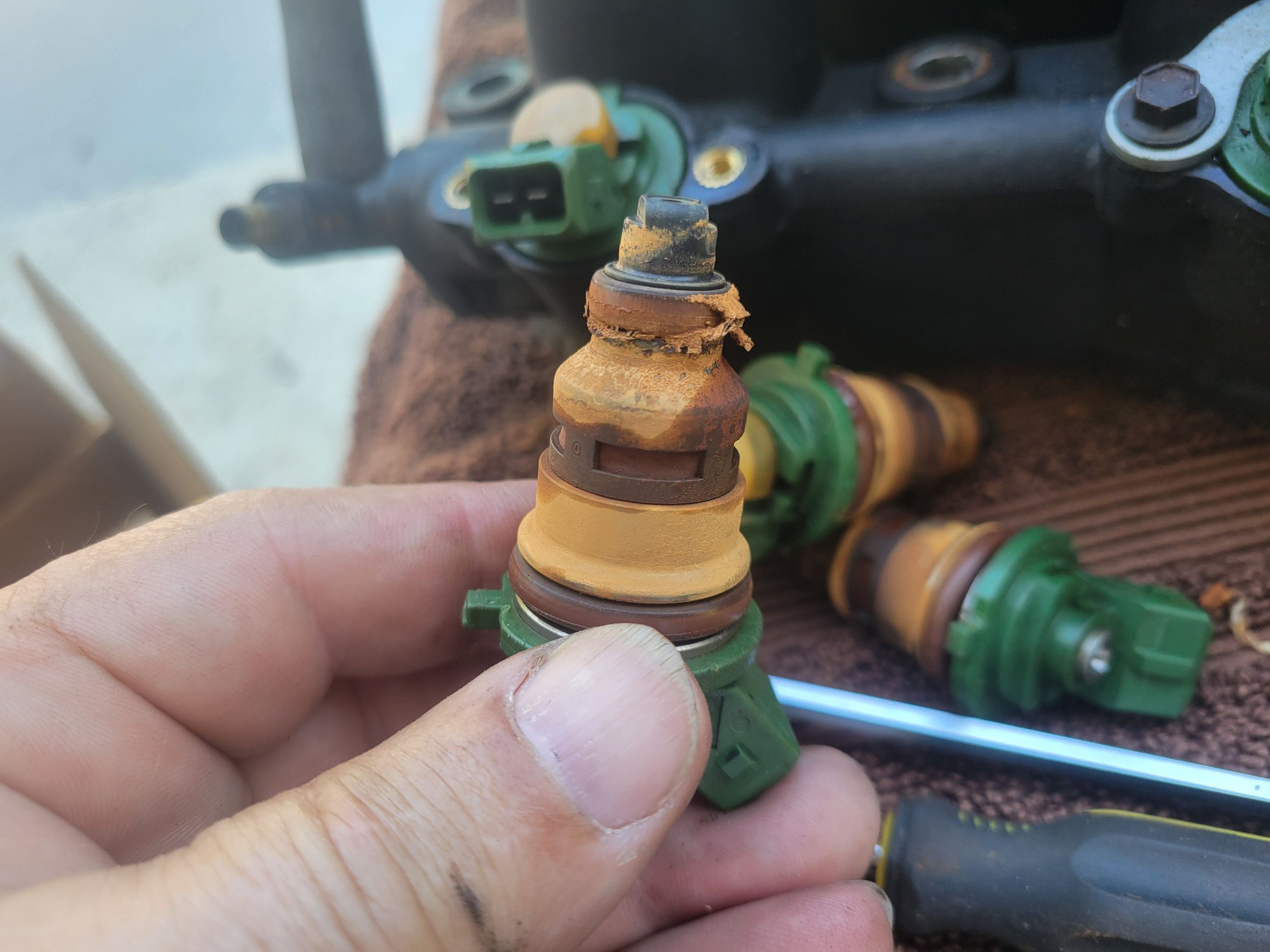

While working on the ignition problems i decided to tackle and water leak i have at the bottom of the water tower. The leak turned out to be the heater hose so i removed the intake manifold. While removing the gas lines i noticed rust in the lines. pulled and injector and lookie here! So now I'm cleaning the fuel lines, injectors and intake manifold. I also noticed rust in the fuel regulator which could all contribute to my problems. I will retest after all this work is done and report. Thanks for all the help.

Well.. here is update. Cleaned the intake and all injectors. Tested each injector and all are good. Cleaned and Tested the fuel regulator with a vacuum and opened and closed properly. Changed the fuel filter. The old filter had pieces of rust coming out of it. Drove the car and great for about 1 hour then started to get hesitation. Hooked up a fuel gauge and taped it to the window to get a better understanding on what is going on. I ran a steady 39 to 44 psi and then suddenly the gauge started to fluctuate between 35 and 40 back and forth even at idle. Suddenly it dropped to 10 psi and the would not accelerate. So I think I found the problem. I replaced the fuel pump at the start of all this so I'm thinking either a bad pump or some debris is clogging the pump and or the filter. Any thoughts. I would hate to do the fuel pump again. Thanks

Finally finished the fuel system. Removed the fuel tank and found lots of rusty fine power. the screen on the fuel pump had about 1/8 inch caked on goo. the fuel filter was also clogged. So i did the muriatic acid soak and got rid of almost all the rust. Flushed the tank about 10 times and then coated the tank with KBS tank sealer. I also updated the one way return valve with a new aluminum valve. Waited 5 days for it to cure properly. Must say it looks like a new tank. Cleaned the fuel pump and screen. Installed a new fuel filter. Cleaned all the Injectors and cleaned the intake manifold. I'm getting 50 psi on the fuel rail now. Runs like a champ. No more hesitation or stalling. I hope this helps anybody else with the same type of issues.
