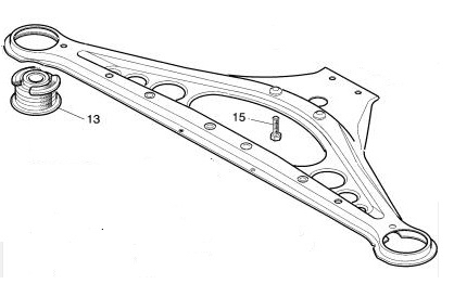

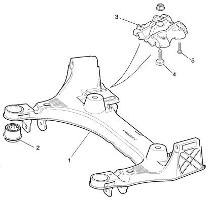

Assuming there has been no previous accident damage which may have resulted in misalignment, have you checked front Crossmember Bushes (item 2) and Vee Mounts (item 3)
and rear suspension subframe bushes (item 13) are intact?
The Vee Mounts can leak or even break up. Steering Rack mount bushes can also fail allowing the rack to move laterally.
Attached Thumbnails 1998 XK8 Dangerous Steering-front-crossmember.jpg   1998 XK8 Dangerous Steering-rear-subframe.jpg

Thank you for the ideas. Items 2, 3 and 13 all checked. I lifted the car right off the ground & could not see any significant deterioration on any of the joints. Nor any others. I also checked the steering rack mounts which were tight and the rubbers looked sound.

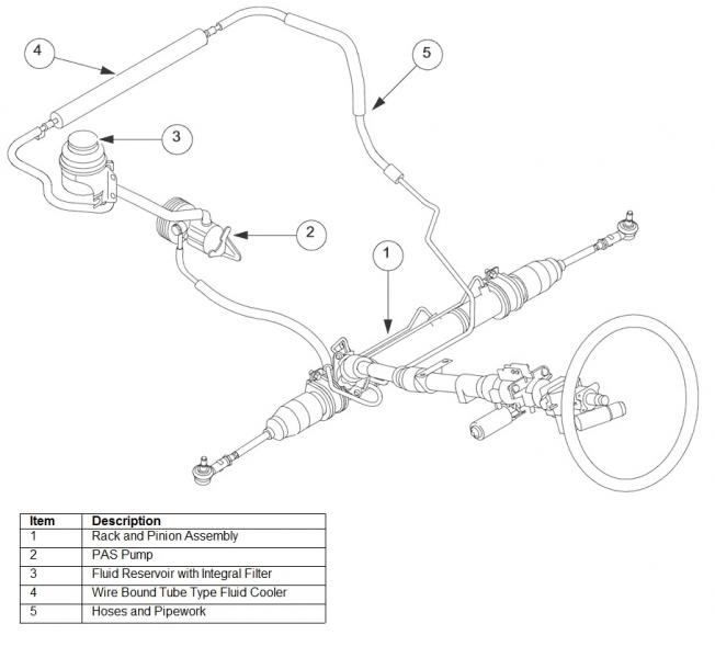

The power steering action sounds very odd. It should be smooth from lock to lock and this could well be the cause of the handling issues on cornering.
As you'll already have seen, there's quite a lot of plumbing around the rack. This diagram should help identify the relevant pipes:
The bleeding procedure is as follows:
1. fill the reservoir to the bottom of the filler neck
2. allow any air to escape (bubbles stop rising)
3. top up if necessary
4. raise the front of the vehicle and support it on stands
5. do NOT start the engine, turn the steering from lock to lock three times
6. start the engine, immediately top up with fluid if any air is expelled
7. turn steering from lock to lock three times
8. switch off and lower vehicle
9. top up reservoir to Max mark on the filler cap dipstick
10. refit filler cap
There should be no loss of fluid from the rack boots.
If bleeding doesn't resolve it, the pump or rack are the next suspects.

I have blead the steering exactly as described. With the engine running the power steering felt much better when I pushed the wheels from lock to lock. I think that by pushing the wheels from side to side with the engine stopped I must have sucked air into the system.
