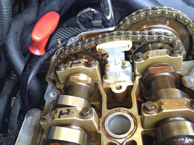

It did prime tight to. Now to safely back off a tooth and Ill have it done. Just hold chain up undo cam and back off 1 tooth. Any suggestions b4 I do it. Thanks

Oh, and this time either pop out the ignition fuse also when you crank the first time (#18 in the engine management fusebox-passenger side(right) up near the windshield) or release the pressure in the fuel line after you pull the fuse pump fuse.

Remove tensioner? Dont remove cam Caps? How about leave tensioner remove cam caps, Tilt cam up and back off tooth. Tensioner will hold chain up. Just needing a clearer understanding. The tensioner isn't easily removed because of the bottom being so big.
I fought that and maybe why its off a tooth.
Can't figure out how Zip strap didn't work.
Can't zip it now I don't believe.

The problem was not the zip tie. It probably jumped on startup when you had the tensioner installed from the wrong side, or it jumped on start up because there was some fuel in the line and began to start before the tensioner filled with oil.
I think if you remove the tensioner completely there is enough slack to move it a tooth. Yes, to get the tensioner out, you will have to remove the cam caps and tilt the cam, just like the original instructions.

The fuel injection fuse is actually the best because when it is out the fuel injectors themselves will not open. Therefore, the engine won't get even one drop of fuel. It won't fire at all.
For future readers, when using the zip tie method, it involves a minimum of three zip ties. One on each of the cam sprocket/chain interfaces, and one on the primary chain sprocket/chain interface. This ensures that *all* of the sprockets maintain their relationships with the respective chain. It also does not hurt to mark the relationships in case a zip tie breaks. Or, use two zip ties at each of the three locations.

The moral of the story. Not only take fuel pump fuse out but make sure plug wires are off. mine had enough fuel to fire without fuel pump fuse.
