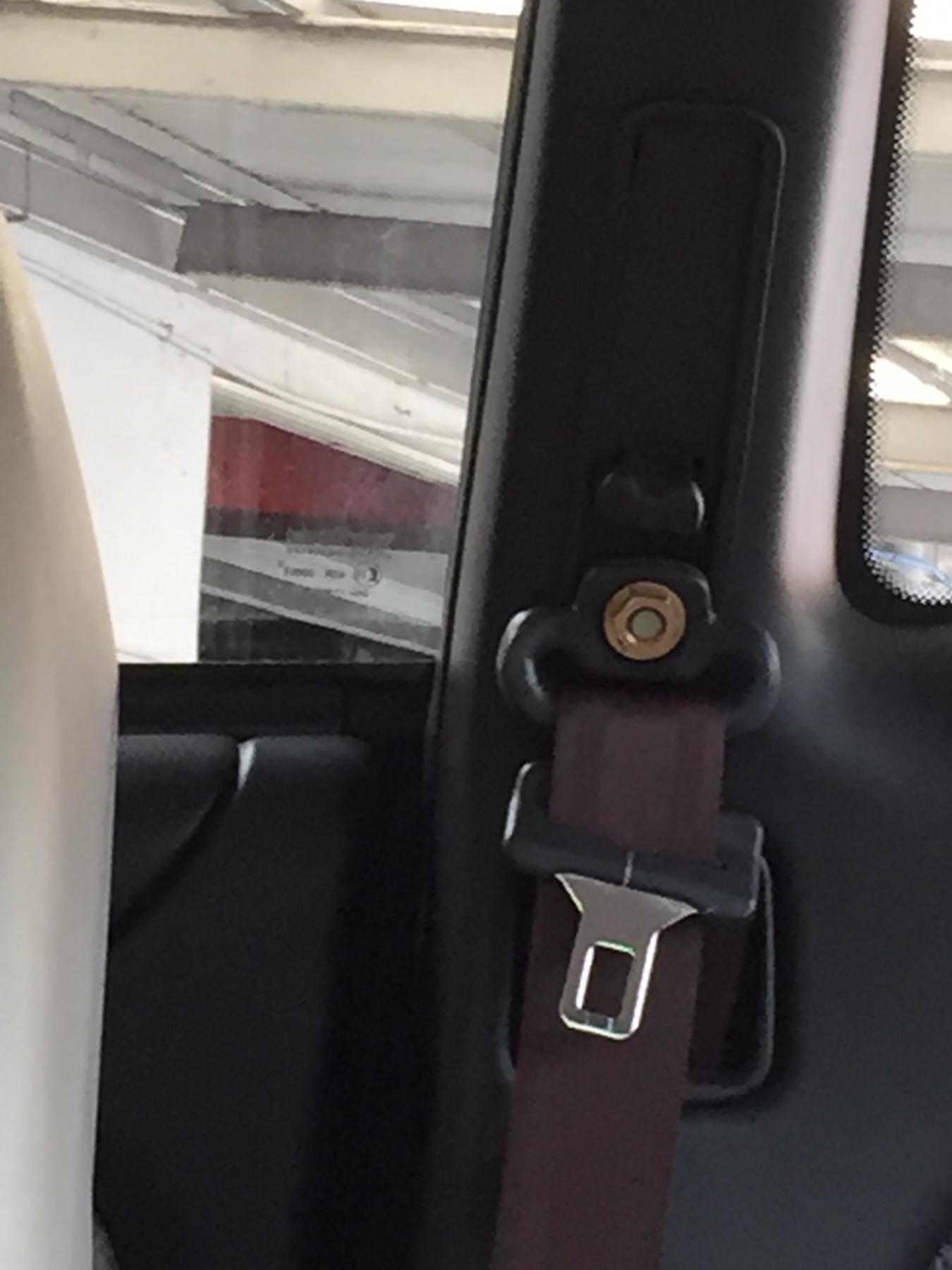

Hi All. My first post. I need help. I am looking for the part number/description of a seatbelt cover for my 1998 Jaguar XK8 Coupe. The interior is code is AGD and the plastic material in my interior is brown/blackish in color. Anyway, i've attached a photo of the interior and the seatbelt. As you can see, the bolt is exposed. I'm looking for the part that covers that area. Any help would be appreciated. Thanks.

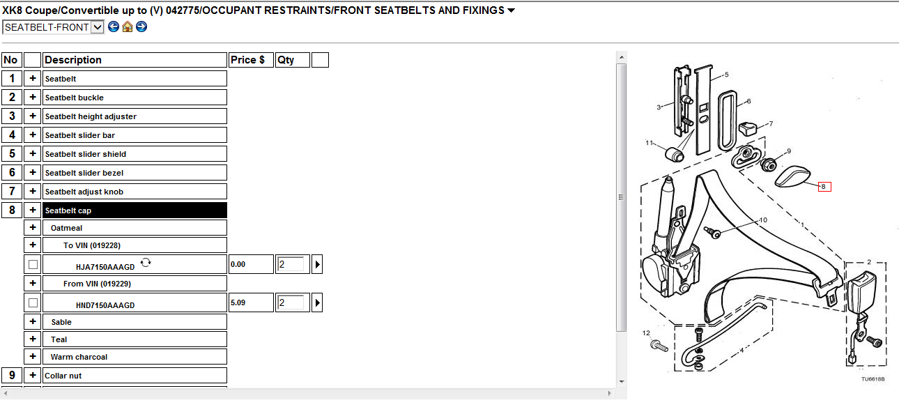

AGD trim is "oatmeal". In your picture it looks darker than "oatmeal", but here is the part number:

Interior trim items re usually the first parts to disappear from Jaguar's inventory but forum sponsor S N G Barratt lists the Seat Belt Cap in Oatmeal available for your model:
P/N HND7150AAAGD
