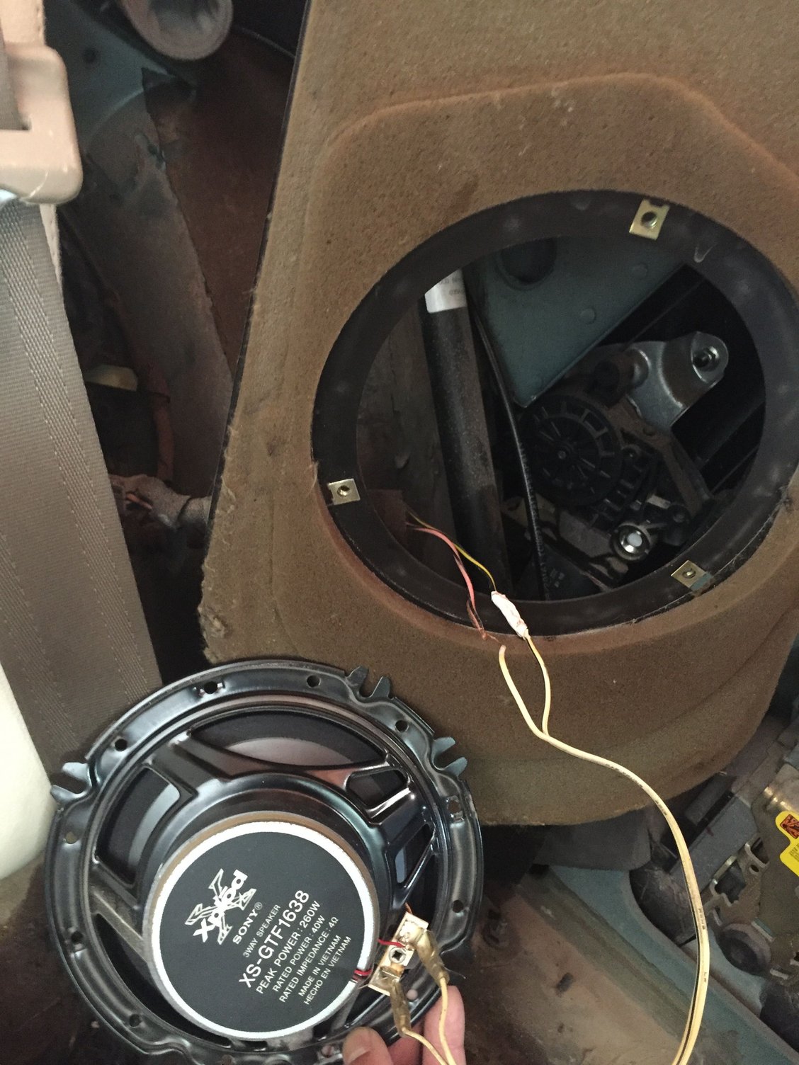

Default Kicker 10CVT654
thks for the advice. That’s the rear quarter panel sub woofer. I adjusted the quarter glass so know how to get in there. Repair seems easy enough re using the existing speaker support ring. Any idea on the door speaker?

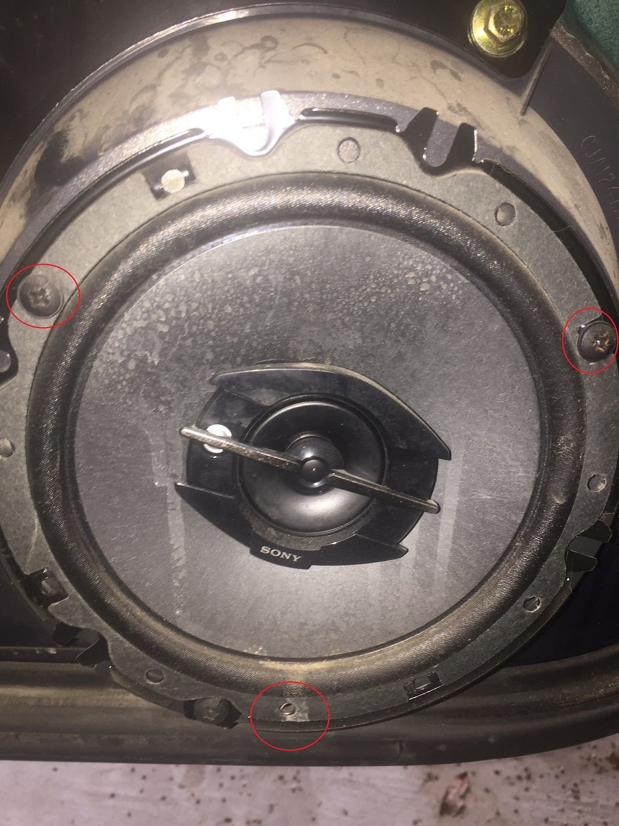

Default Door speakers in
We had a recent severe thunderstorm, so I was limited in what I could do with my new speakers. I did manage to get the driver's door speaker in and glad I did as I could directly compare the old RHS with the new LHS.
The installation was easy, with simply getting the door card off and looking to see what I was dealing with.
As suspected, the previous owner had put in Sony speakers, with the fixing screws at 10 o'clock, 2 o'clock and 6 o'clock. The bottom screw was actually missing, which might explain the tinny rattling.
I've always hated this situation - the wires were just wound together and duct taped. Maybe another reason for the poor sound quality. I went with soldering and heat shrink wrap.
Anyway the Kicker 43DSC6504 install was easy. I checked fit up before anything else. The Kicker speaker came with multiple holes pre-drilled into the surround for different holding configurations, and I didn't need to drill.

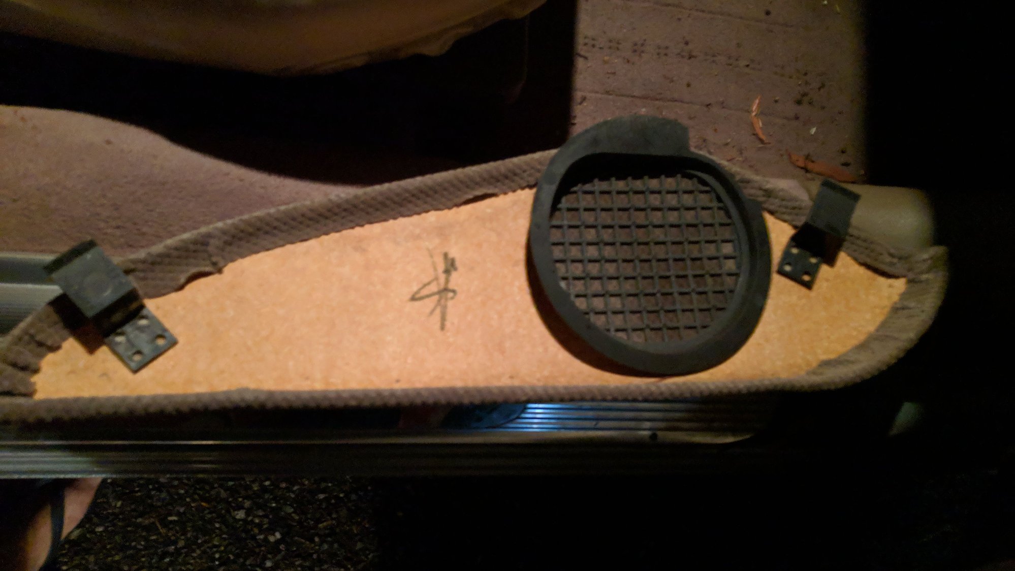

Quick note: you may be able to access the speakers without taking the door card off.
On mine there are two screws underneath the area of the door where the speakers are, and with the screws out the darker speaker cover area pulls down and out.
I wish I had known about this when I replaced mine.

Did you look under the door? These two screws were shiny silver and not covered, so they were positioned way underneath the door where they wouldn't be seen.
Run your hand under the door, along the horizontal where the door card would meet the door sill plate.
And if all else fails, when you do take the card off, inspect the area to see if there was a removable panel after all, so you'll know for next time.
I learned about this trick on the forums not in a thread about speakers but about window adjustment. Taking off that speaker panel and the puddle light shows two adjustment holes for window tilt.
Actually, since I happened to take pictures of doing this yesterday, these might help someone.

Volkris,
Thanks for the pics. I couldn't feel the panel screws, but I figured this speaker door panel had to be fitted somehow to the door card. I had to get on my hands and knees and look, and bingo they're there right where they are on your pic, 2 small recessed screws.
You just saved me breaking more of those old brittle plastic fir tree fixings that hold the RHS door card to the door frame - esp. as I'm in a 20 year old XK8 in Bahrain Desert Climate. Hate old plastic!
