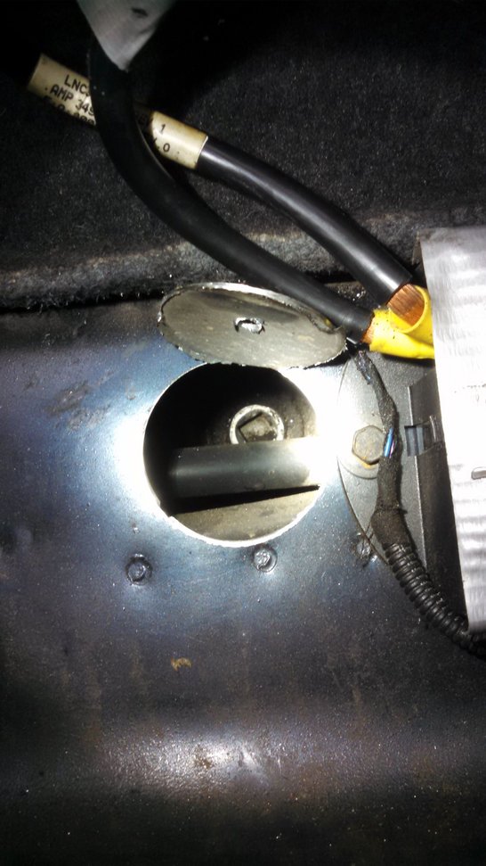

Originally Posted by Norri
Good advice, but, I don't know about the XJR but on the XK8/Rs it's not a simple job due to the fill plug location.
Nothing that a 2" drill bit can't fix:-
https://www.jaguarforums.com/forum/x...er-way-146725/
