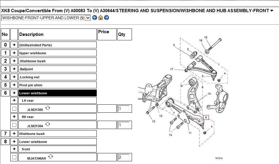

Old Jan 12, 2014 | 06:34 AM
It looks like you have quoted Part Numbers from an aftermarket supplier and not the Jaguar numbers?
Jaguar do not list replacement ball joints but they are available from aftermarket suppliers as are refurbished wishbones.
Check this recent thread for information on replacing ball joints:
https://www.jaguarforums.com/forum/x...joints-109703/

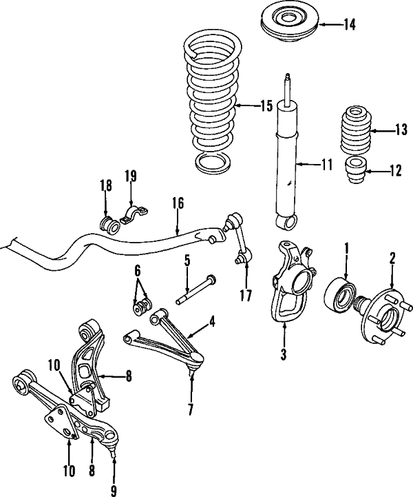

Sorry about this, I mis-identified the control arms by car has. I guess it has the follow-on variety. Are these better and less prone to failure?
I still have the questions above too.
