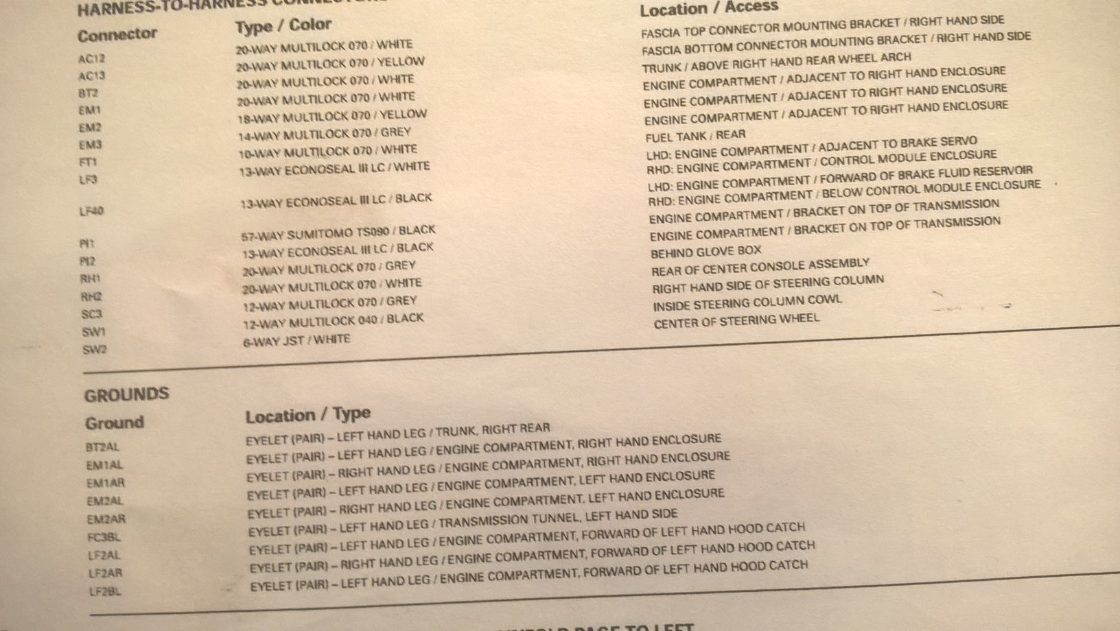

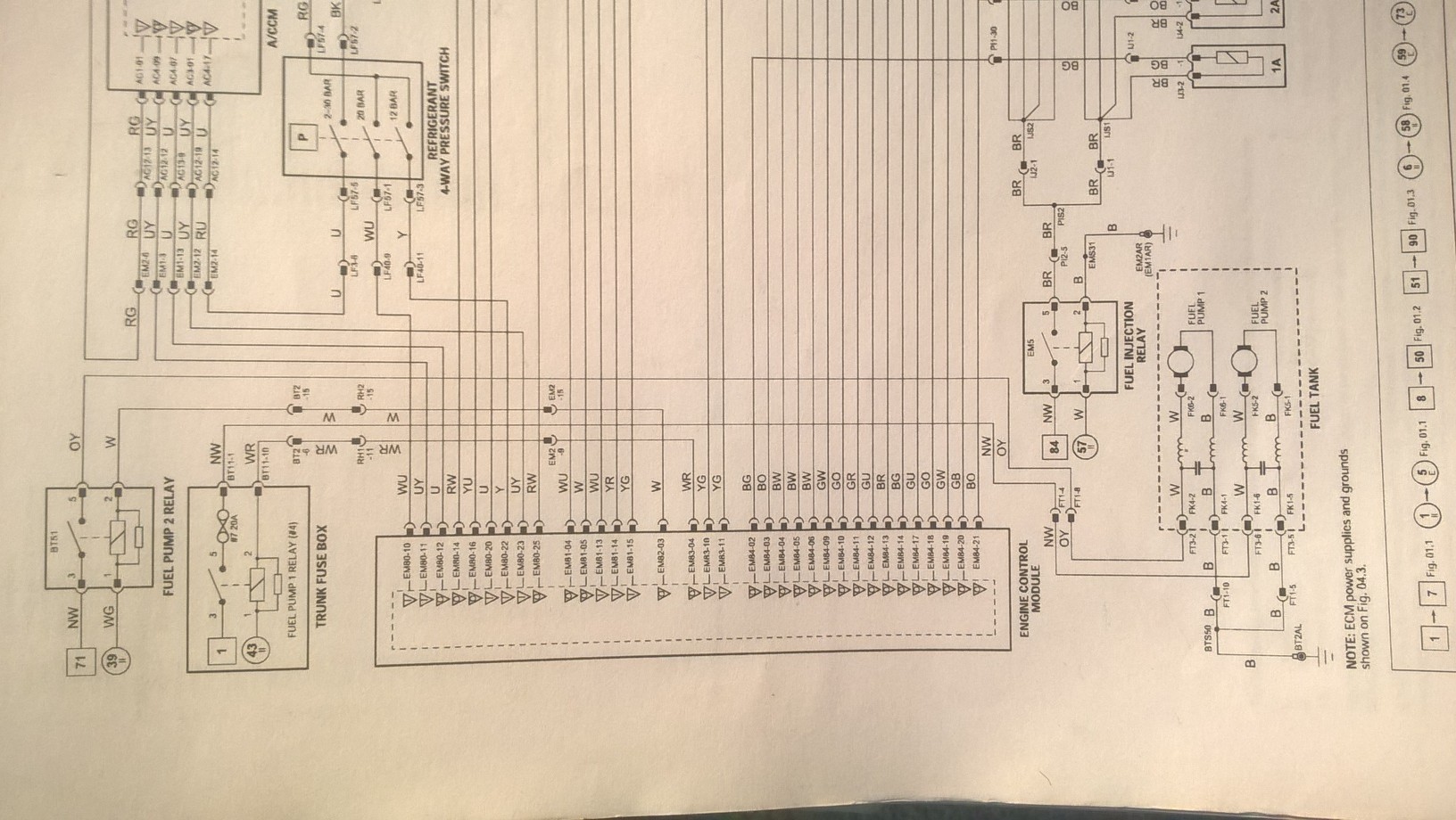

You said you checked all the fuses, however did you pull them out and check the ones in relation to the fuel pumps. On Fuel pump relay 1, there is another fuse, #7 in the fuse box in trunk, between relay and pump. Don't forget fuse to the relay as well. I've had fuses that appear to look ok when still installed, but once removed there's a tiny break, but will still have power on one side.
It's possible it could be an ECM issue, I've had a few of them come in for service, then wont start after. Took the ECM out and sent away to someone who repairs ECM's and other control modules.
