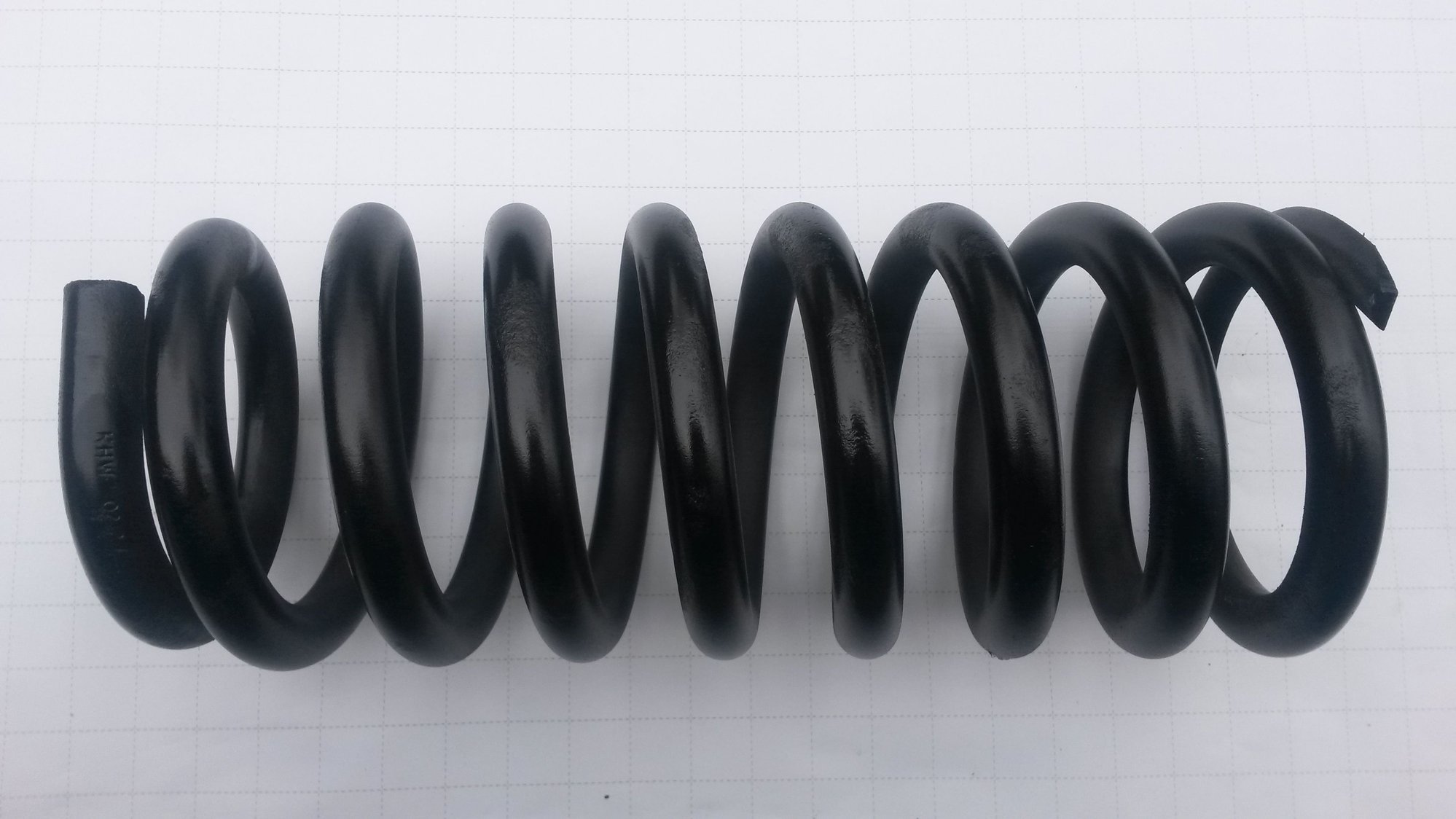

Jlewis468. I suppose it can be done but it’s a bit of a cowboy thing to do on a high-performance Jag!!
If you are just touching the rears then here are a few considerations that I can think of. I’m sure there’s other issues too! :-
* The suspension on these are finely set-up with a CATS system (Think it was standard on XKR), the front-to-rear stability will be affected in certain cornering situations.
* If your car has auto headlight leveling, then you will need to somehow compensate at the rear sensor linkage.
* There will be an issue with the trimmed spring because the bottom coil fits into the cast seat moulding of the wishbone. If you trim off the bottom coil, then the spring radius will be bigger and it’s different curvature will not seat correctly. Also, the top of the spring is flattened to engage within a cup retainer. Trimming off the top coil with cause the load to sit unevenly and the spring will bend a little sideways. I think the cup will eventually damage.
Personally, I don't think you should do it. It is what it is :-)
