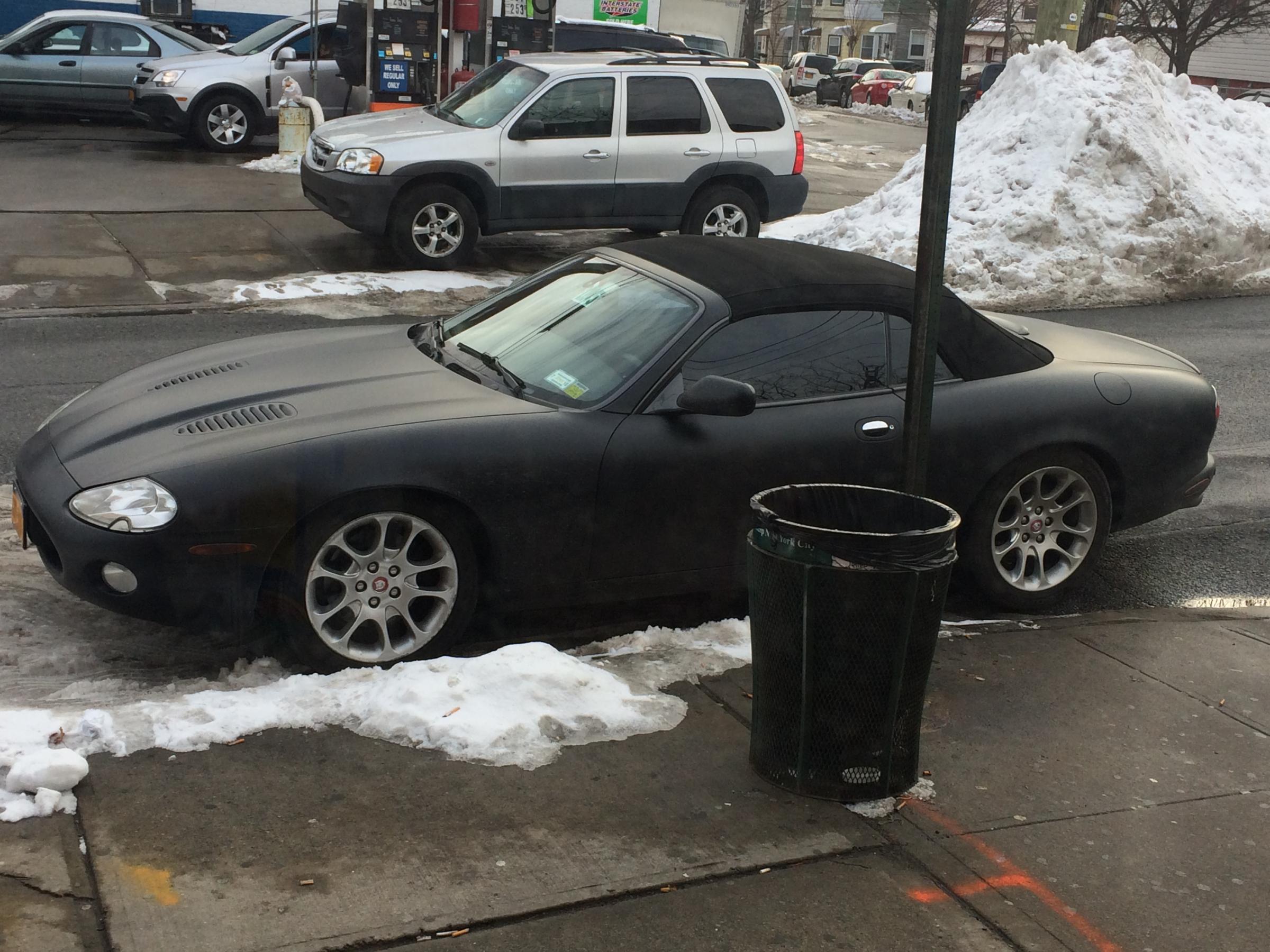

Do you think you could post a full sized picture of your car? I am curious what it looks like in flat black. The earlier pictures you posted were tiny.

Well I took one at the store today because I was so happy to be driving it again....I warn its VERY DIRTY now...Ill take some better ones once it gets nicer out. I really have no good photos of this car. In person everyone loves the look. This should come out full size

reflection is from glass
