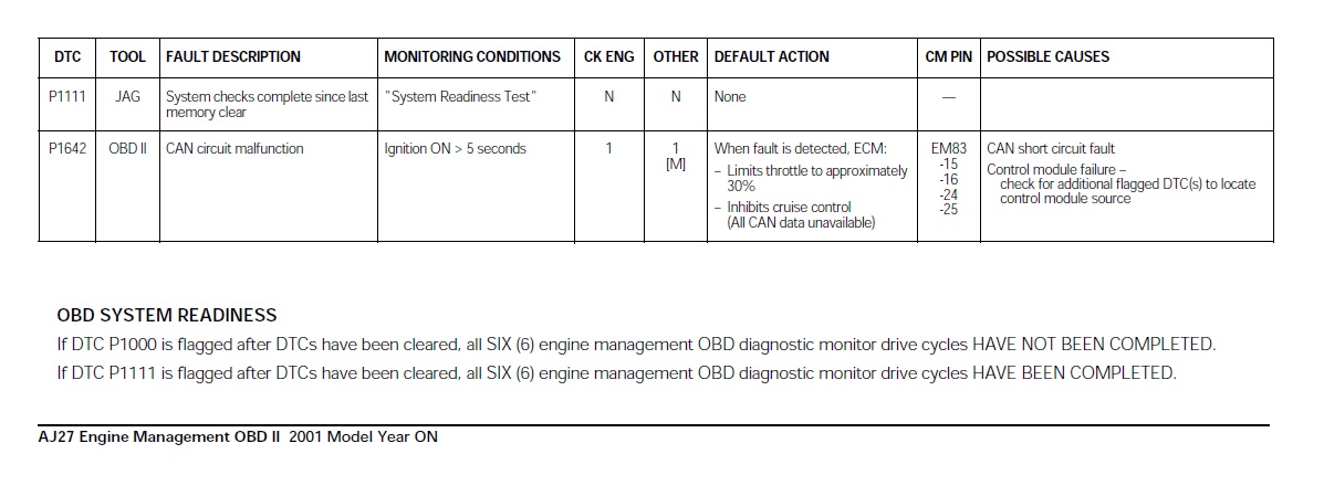

Excellent advice from Steve. Impossible to troubleshoot one of these vehicles without a Code Reader.
Generic descriptions of codes can be misleading and it's best to use the Jaguar DTC Summary List. For the codes you have, this shows:
P1111 is not a fault but an indication that all monitoring tests have been completed since the last memory clear.
With P1642, it's normal to find additional codes indicating which control module is the source of the fault.
That being said, where there's any suspicion of tensioner issues, I wouldn't start the engine until the cam covers have been removed to check.

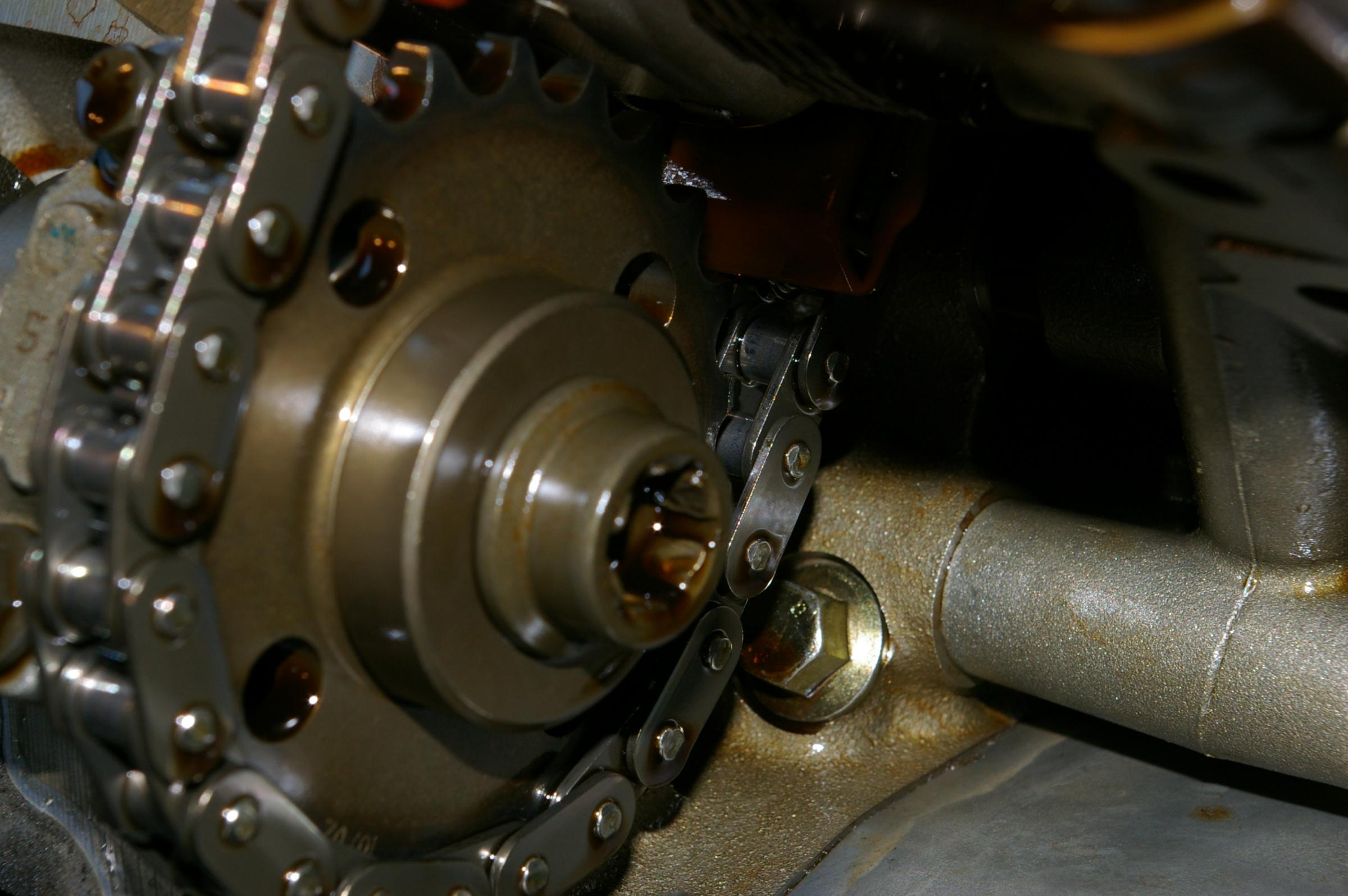

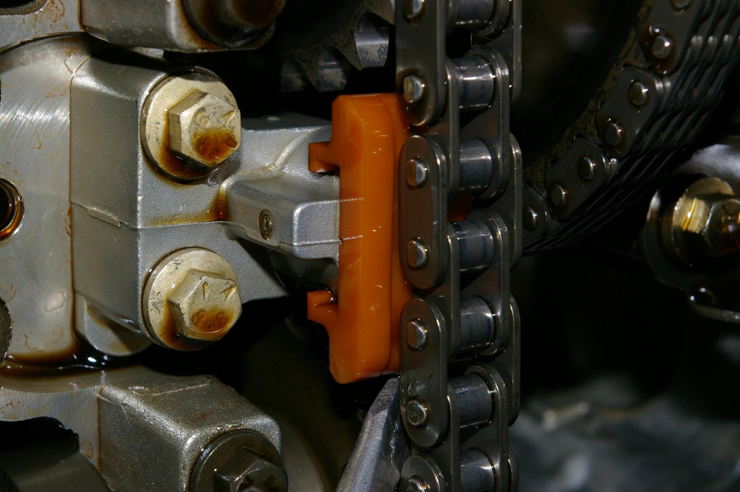

The latest. Being apprehensive about my mechanical abilities I, nonetheless, braved removing the right valve cover. Here are a few pics. Looks like the metal tensioner. There's a little bit of slack in the timing chain -- maybe an 1/8th of an inch. I assume this is normal? Also, I'm not sure how to align the cam flats do I crank on this (see pic) and, if so, clockwise or counterclockwise.
Sorry about the dumb questions. However, I've learned the only dumb ones are the ones not asked.
Thanks for your help, guys.
Karl
Attached Thumbnails 2002 XK8 - ran rough and quit- codes 1642 & 1111-imgp4425.jpg   2002 XK8 - ran rough and quit- codes 1642 & 1111-metal-3rd-generation-tensioner.jpg   2002 XK8 - ran rough and quit- codes 1642 & 1111-some-slack-maybe-one-eigth-inch.jpg

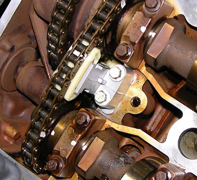

You have the Metal Tensioners.
To rotate the Engine, Use a 24mm Socket on the Crankshaft Bolt and rotate the Crankshaft Clockwise (as viewed looking from front to rear).
Rotate until the Flats on the Camshaft are aligned with each other. They should be in almost perfect Alignment. This view shows the Flats in Alignment.

Originally Posted by kwernick
Vector, are you still flying? I'm looking to upgrade to a Mooney M20 (I think a "J") that I'll own in partnership. It's a faster airplane, more carrying capacity and the partnership reduces the downside risk. Additionally, I'll be hangared which is a real plus in the winter (and summer for that matter). Karl
No, not flying anymore. It was a lot of fun though! Mooneys are fast, bro! Good on you!
Glad to see you have the metal tensioners!
The "cam flats" are circled in red in the attached pic.
Vector
