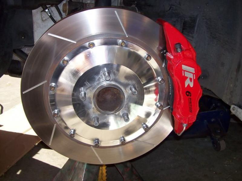

Yes they will with a bit of work & a lot of money. That is my car with the early brake disc it has since been uprated to 410mm Wilwood
Wilwood High-Performance Disc Brakes - Rotor No: 160-8955-BK
The calipers are from an XKR Portfolio with custom caliper mounts & brake hoses made up for me. The rear are Alcon calipers with custom caliper mounts & standard Brembo discs. The hats/bells for the front discs were made at a local machine shop.
