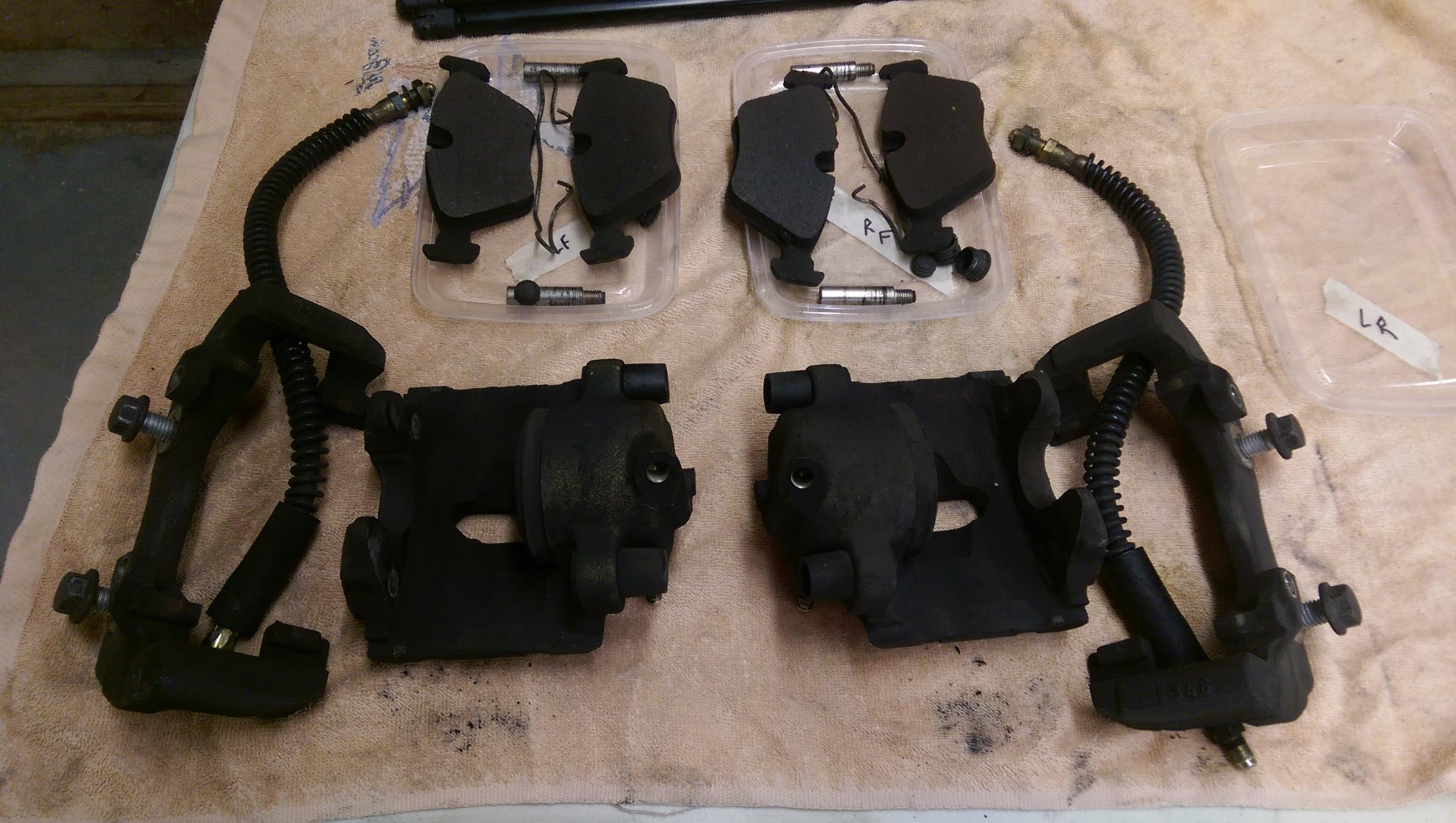

Are you sure you have a two piston caliper? I've just removed mine for rebuild and painting, my xkr has 1 very large piston.

Not sure about your mechanic but those look like stock 02 xkr brakes.
Notice you can see the outboard brake pad, so there are no pistons on that side and are pulled on the slides when brakes are applied, the piston is on the inside, turn your wheel and look at the back and compare to my pics. Jaguar did a pretty good job on the XKR brakes and they have very good stopping power, can you do better sure, with enough $ anything can and has been done with one forum member or another. There are some threads that discuss performance tests and will point you to articles on this (I remember reading them some time ago).
