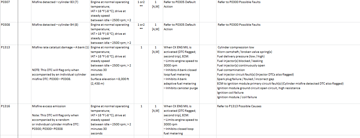

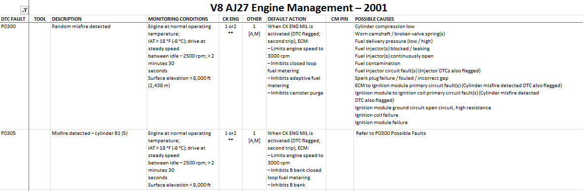

Misfires being reported, all on one bank (B):
I've included P1313 as the P1316 refers to it.
Could you try a $0 test? - switch the coil for B2 (6) across to its opposite on Bank A and see what happens. I'm wondering if this coil is affecting the others on the bank. If it is, then the codes should change.
Or swop out coil B2 if you have a spare.
