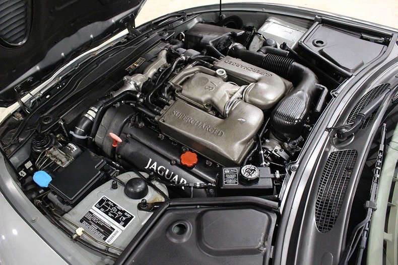

Those are numbers that would match up perfectly with an xk8, not the XKR. You sure it's the supercharged model? Post pics of your engine!

Trust me, it's an XKR. My original question arose in relation to whether the supercharger is actually... well... supercharging.
The belt & pulley look good, the intercooler pump comes on with the ignition in position II, and there are no lights, messages or OBD codes.

Roger_B Looking at your picture that engine bay and those hoses look so clean and shiney, almost oily.
Are you sure the SC belt is not slipping? With that much oil/shine around it wouldn't squeak/squeal if it was!
