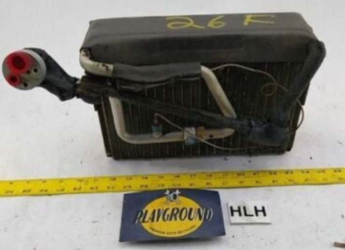

Originally Posted by 73MustangBill
They do, buried in the dash. HUGE job to replace, but I understand they rarely go bad.
Thanks Man!
I shouldn't have been so lazy and looked it up myself. From this (and having spent WAY to much time under and behind my dash on the 04) maybe it's not that that bad a job...
Thankfully, lucky stars, I haven't had to KNOW where this bit is,,, yet... I found these two pictures. The diagram is the 98 drawing but I think it may hold true for all cars based on the second photo,,, which is advertised as for 98-06.

The process is simple too.
1. Remove everything within 5 feet of the expansion valve.
2. Remove expansion valve.
Installation is the reverse of the removal process.
To a degree,,, 5 feet is about right! Learned this the hard way trying to take shortcuts and being lazy when I had to replace EVERY doggone servo motor for all the doors and flaps in the 04 HVAC system. Talk about cursing and swearing,,, with feet up in the air no less. Holy bologna!
