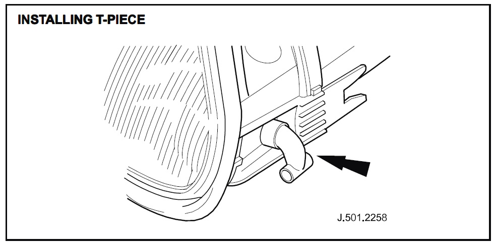

The 'fix' is to drill a hole and fit a Tee Piece vent pipe (Part Number LJE 4133AA ) to the headlamp shell:
Although this can reduce the condensation and misting, it doesn't entirely eliminate it. The TSB's suggest replacing the headlamp in the case of serious customer complaint.
