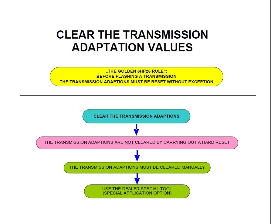

Old Jul 21, 2013 | 09:39 AM
Likes: 17,016
Jon,
From the ZF 6HP26 Troubleshooting Guide:
(click on the images to enlarge them)
Looks like you're stuck with the Dealer or an Indy with equivalent diagnostics to clear the transmission adaptions.

Old Jul 22, 2013 | 09:48 AM
Posts: 121,184
Likes: 6,658
Doesn't the "Golden Rule" that Graham posted say that the adaptions should be cleared before updating, or am I reading it wrong?
