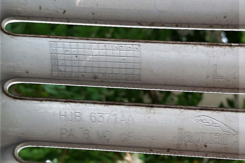

Here is an easy way to get some evidence of the manufacture date of the XKR grill, which could help settle what is going on here.
Look at the latest date marked in the manufacture date record on the underside of the grill on the hood.
Here is mine:
The latest dot in the table indicates that my grill was manufactured in March, 2000.

Lightbulb Occam's Razor
Originally Posted by reedmtn
Would that really even make sense? Think about the expense and trouble one would go through.
Respectfully, it is much more likely and less "complex" a hypothesis that a previous owner simply (and it is very simple) re-badged the car, added the XKR hood, rear spoiler and wheels than this being an undiscovered Jaguar prototype..... although it certainly isn't impossible, as stranger things have happened.
The tip offered above to check the manufacturing date on the hood vents should settle the question effectively though. Great guidance there and look forward to what you find. Please post a clear high resolution photo of the date code on your vents and the experts here can take a look.
This is true of most parts too BTW, such as the wheels. They should have a date code somewhere.

I think the guidance about the casting date on the vent will settle the question. And checking your VIN can as well. You also could reach out to the Jaguar Heritage Trust to see what they know if you want to ask the "historians".
I still think it is most likely you simply have a car that a previous owner had some fun mod'ing to look like an XKR, and there's no shame in that
