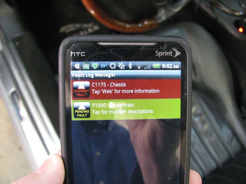

Fellas, I'm telling you, the ABS on the jaguar won't be able to be read by Autozone's $100 scanner. If they do, please post it here with a pic of their scanner showing the code, and I'll mail you each $50.

You know my address, but I prefer PayPal. If you're going to send it through the mail, please send a single $50 bill and write "Reverend Sam is a Jaguar GOD" in big letters across the front of the bill. ...and sign your name to it. I will permanently affix it to the wood veneer on top of the passenger air bag so that my passengers will always know who they are dealing with. I might even drive out to Dallas and give you a ride in the car, just to rub it in.
OK, fine! That isn't the $100 Autozone scanner. That's my $45 bluetooth OBDII reader I ordered from China and a $5 app for my Android phone called "Torque". It reads all sorts of groovy stuff. Unfortunately it doesn't read transmission temps. It does read the chassis codes, however, including the wheel speed sensor codes. That code above, C1175, indicates a problem with the left front wheel speed sensor. I went out to the garage, cranked the wheel all the way to the left, and I was easily able to disconnect the connector to cause the code.
I discovered that my bluetooth OBDII scanner would read wheel speed codes yesterday when I was installing the rear window switch. I accidentally left one of the connectors in the tunnel disconnected and I got two wheel speed codes along with a few others. I like my cheap, Chinese, bluetooth OBDII scanner more and more every day. It stays permanently connected in the Jag. I think I'm going to buy another to attach to the Expedition. With all of the technology in cars today it seems like manufacturers would just enable the cars to display that info without having to use a DTC reader, however I guess the dealers make good money from reading codes and fixing whatever is causing the problem. If anyone could read their own codes, along with a description of the problem and a list of potential solutions simply by pushing a few buttons on the dash, dealers would lose out on a lot of repair revenue.

I am impressed, truly, that the android app can actually pull some non-drivetrain codes.
Unfortunately, isn't C1175 left REAR wheel sensor fault? And you say you pulled the left FRONT connector to initiate a code? I hope you went to the back and tore that corner apart looking for your suspect.
