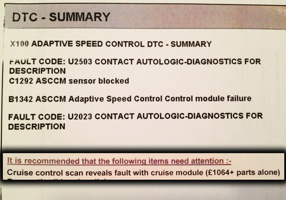

Last year the Cruise control started going intermittent with the amber light showing on the dash and "Cruise Control Not Available"
But now it doesn't work at all.
Every time I start the car, after about 5 seconds it say " Cruise Control Not Available" with the amber light.
I did go to an independent garage last year which gave the following DTC faults codes: (not OBD)
U2503 Contact Autologic-Dianostics for description.
C1292 ASCCM Sensor blocked.
B1342 ASCCM Adaptive Speed Control Control Module Failure.
Am I right in thinking that the Cruise Module is the sensor behind the front bumper?
If so, are there any checks I can perform? Anything I can do to fix it, or have it fixed?
The garage quoted me £1064 for the part.
I've attached pics of the sensor/module behind the bumper and the report from the garage.
I did serach the forum, but couldnt find anything relevant.
Thanks in advance.

These are weird codes.
C1292 is not listed as an XK DTC
The others don't add up
B1342 CPCM Telephone Control module failure N — CPCM failure
B1342 DHRCM Driver Seat Head Restraint Control module failure N — DHRCM failure
B1342 DSCCM Dynamic Stability Control Control module failure Y*— DSCCM failure CHECK ENGINE MIL
I suspect the code reader.
This message (not these codes) can be due to a number of things - as simple as a bad brake light switch.
Do you have access to another code reader?
Is the MIL light on ?

Those codes were from the independent garage who are a Jaguar /TVR specialist. Although they mean nothing to me.
The MIL light is not on and I don't think its logged any other codes.
I'll plug my OBD reader in this evening and see if its shows anything up.

You can see from my post that if the MIL light isn't on then the B code is spurious.
Post any codes + get help checking the brake switch operates correctly.
Having said that there are two brake switches and either one can cause this problem.
Have a bit of a Google and see what you turn up.
DTC is another name for OBD, just a cheapo OBD reader can't access most non Pxxx (powertrain) codes.

I have the same problem with mine XKR 2001 the module is behind the front bumper, the cause is the module isn't communicating with ECM, BBA Reman can sort this out, go to there site and you'll find it , approximately £600. I,ve been looking on eBay for six months now for a used one, for some reason they're like hens teeth. But check the brake light switch first just it case it might be an easy fix albeit awkward.

I was gonna suggest to that you send it out to a repair/rebuilder of modules. Based on the corrosion on the outside I would venture to say that theres probobly corrion inside causing issues. You cant pull codes with this using a standard OBD2 reader its not a OBD2 item. Its a Jaguar specific item that would have to be read with the correct Jag scanner(SDD) or a proper aftermarket with the capability. But looks like you already have the info. And yes good luck ever finding 1 because theyre rare, and why Ive heard a few people over the years claiming theirs were stolen off the car.
