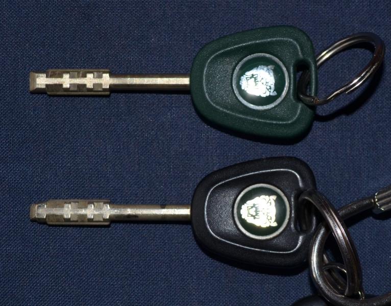

The only difference between a Green valet and a Black master key is the way they are cut. It's not a different chip:
Note the last 2mm (approx) of the Black key is reduced in diameter by 2mm (approx). This is what prevents a Green key from opening the Luggage Compartment or Glove Box when Valet Mode is activated.
A Green key can be converted to a Black key by a locksmith which is one way of avoiding the high cost of a replacement Black key from Jaguar. I've read reports of members converting the Green key by filing it down but this is risky when you only have one key.
The single chime confirms you're entering fob programming mode but the two chimes suggests the mode is timing out without any signals being received from the fob.
