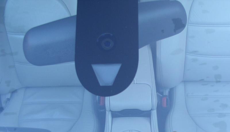

The design has been changed on the 4.2's. No knob on the mirror now and a much bulkier pack for the ambient and rain sensors, masked by a shaded area on the windscreen:
The marks are rain on the screen - not on the seats!
Attachment 17565
Hey G;
Great photo that is it exactly.
So on the 4.2's you have to adjust the auto on for the lights exactly how???

jj,
There's no adjustment available on the 4.2's, it's now a 'predetermined level'.
Just set the rotary collar on the light switch to AUTO. When the light fades to the predetermined level Jaguar have decided justifies lights, sidelights and headlights automatically switch on and the sidelight icon in the instrument panel illuminates. As it gets lighter, the lights automatically switch off again. Recommendation is to leave the switch in AUTO but you can always override it using the rotary switch.
