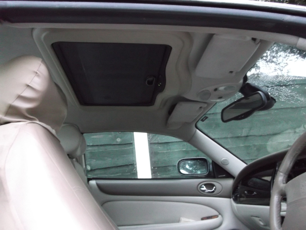

Someone has. I saw this at Blackpool last year:

It looks better than I thought . Problem is finding a complete one with glass and inner and outer frames ..Like rocking horse ****.

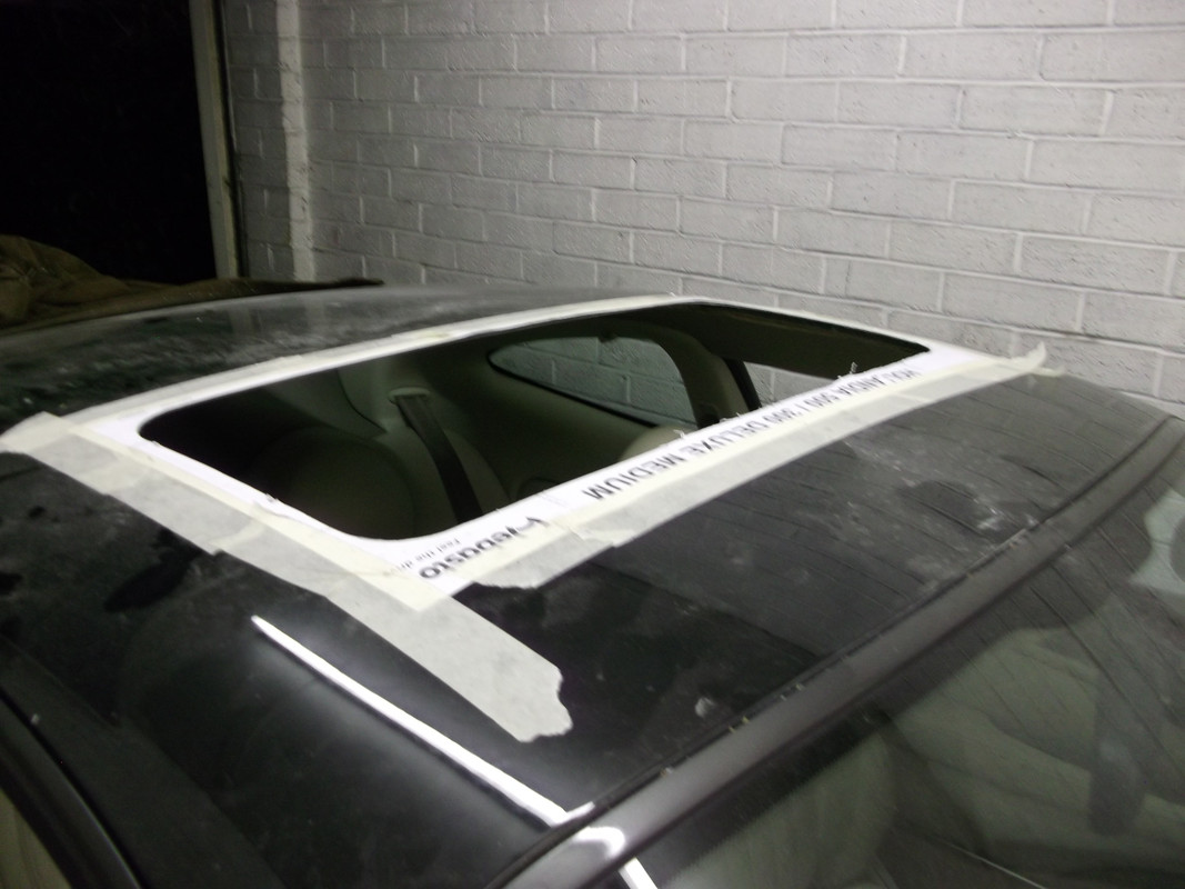

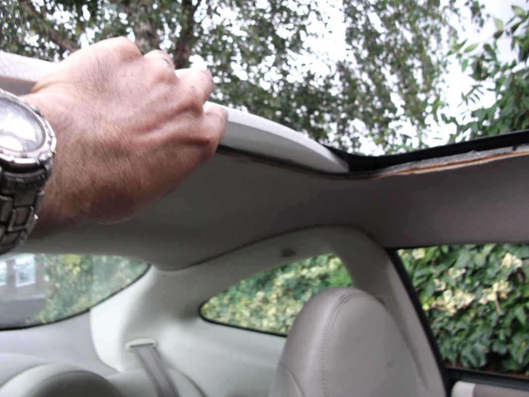

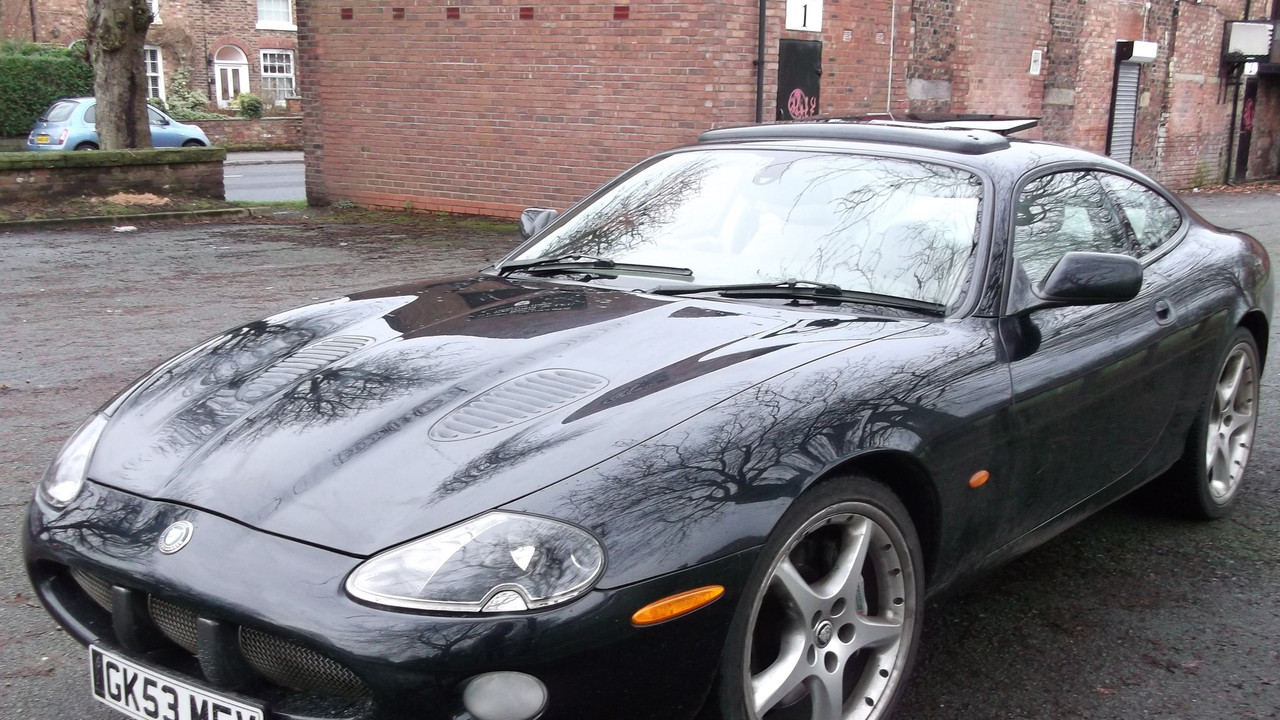

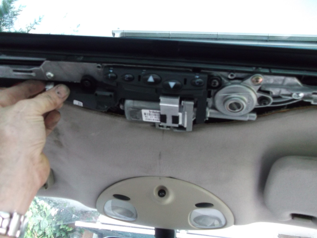

The point i was trying to make (Whitesnake classic) was most on here think it's a bad idea to fit a sunroof, constant leaks and blocked drain holes. It's all bollox. I've fitted electric sunroofs to every car i've owned.(20+) including xk8's and R's, and never had a leak. Aftermarket sunroofs don't have drain holes, period.
Problems began in 1980 when an inferior batch from the far east flooded the market. The distributers ,and i won't mention any names (although Britax springs to mind) found they could make a quick buck by selling to franchises of Motorland and Charlie Brown for £50. These had poor quality seals that would warp in the summer heat and create leaks.
After that came the universal "one fits all" sunroof which had a flexible frame, and would mould itself to the roofline when screwed into place. Yeah right, glass cannot bend so it was obvious it would leak.
The distributors didn't care, they took the money and ran. Gave aftermarket sunroofs a bad name.

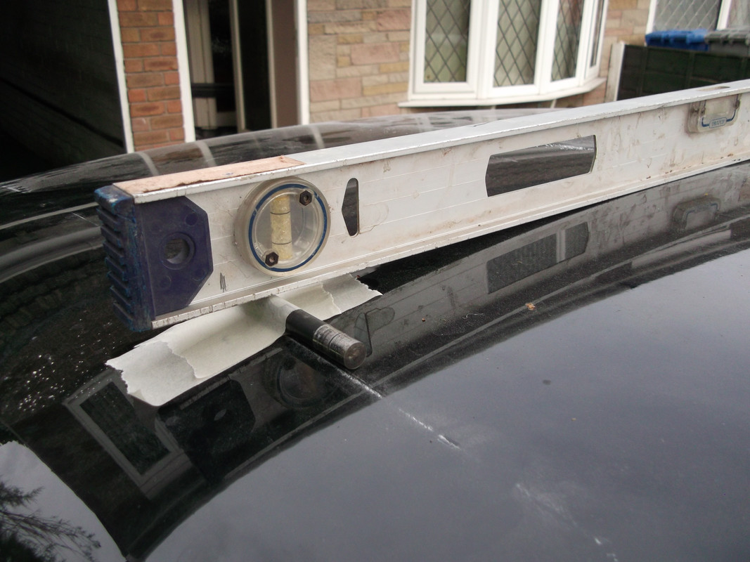

Nowadays we have much better materials like neoprene seals that don't shrink. If fitted correctly, a Webasto sunroof is guaranteed not to leak, and by that i mean both cambers need to match.
You can easily measure you roof camber with drill bits and a spirit level.
Jaguar kindly gave us a centerline at the top of each windscreen. Run a chalkline between them and align the centerline of the template on that. How far forward is personal preference, though you can't go too forward as the inner shroud will foul the sun visors. Leave say an inch gap so you can get your fingers in.
You then bolt the two templates together. This prevents them from slipping while you cut the skin..

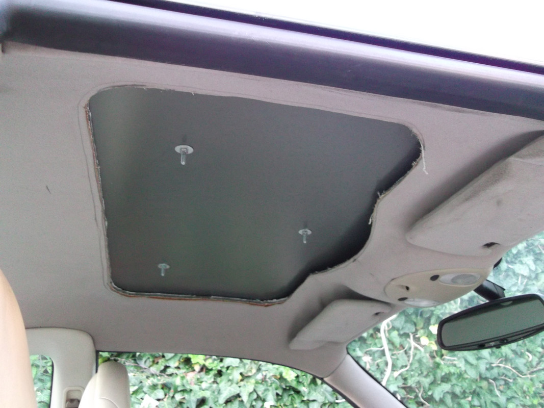

The headliner is cut with a sharp Stanley knife.
The roof is cut with a jigsaw with metal blade.
You also need half inch polystyrene packer at the rear as you need minimum 20mm gap otherwise the shroud won't seal. Once installed it's not noticeable.
Motor wires go down the A pillar to the accessory plug behind the glove box. Earth, live, ignition. simple.
So there you have it, and if fitted yourself the cost should be no more than $700.
Let the flaming begin.

I do appreciate the pictures showing your work. You have way bigger ***** than I, sir. And don't get me wrong. I believe if you want a removable roof on the hood - good for you. A car and especially an XK8 is a personal expression. You could drive an Opel Omega, but chose the Jaguar. If you have beaten the leak dragon, you are one meticulous installer. Like I said earlier, your car shows pride of ownership and we all appreciate that.
