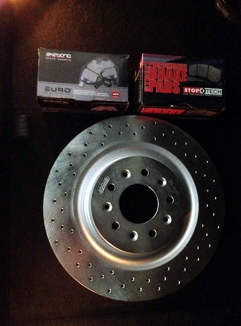

I've recently changed my rotors and pads. Put about 2K miles since then. Everything was great until about a few weeks ago, when I started noticing vibration in the steering column when slowing down from high speed. Slowing down from 50 mph is smooth. The car drives extremely smooth even at 100+ mph. No shakes, no vibrations - just pure enjoyment. Slowing it down is another story. Could it be the new rotors? They're not Brembos. Any ideas or suggestions?
Old Jul 20, 2013 | 06:30 PM
  #29

Clarification - original equipment is Brembo. When I changed the pads (2K miles ago), I changed the front rotors as well. The rotors are not Brembo - that's what I meant.
[URL="https://www.jaguarforums.com/forum/attachments/north-east-us-me-nh-vt-ma-ri-ct-nj-ny-pa-35/40249d1366428815-jagpro-bellmore-long-island-photo-2-jpg"]

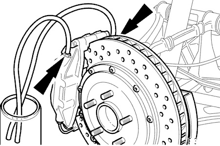

So you have OE Brembo Calipers. A flush could improve the brakes as the bleeding technique is slightly different from standard with the twin bleed screw Calipers and a little more difficult to expel any air.
1. fill fluid reservoir to the 'MAX' (maximum) mark.
2. prepare the left-hand front, brake-caliper for bleeding.
Connect bleed pipes and fluid containers to bleed nipples.
3. bleed the brake.
Apply pressure to brake pedal.
Open caliper's outer bleed nipple.
Fully depress brake pedal.
Close bleed nipple.
Release brake pedal.
Wait two seconds to allow system to prime.Repeat procedure until air-free brake fluid is expelled from the bleed nipple.
Repeat procedure to caliper's inner bleed nipple.
3. tighten bleed nipples to 12-16 Nm.
4. following the procedure above, bleed the brakes in the order shown:
Left-Hand Front
Right-Hand Front
Left- Hand Rear
Right-Hand Rear
I've never been convinced the order the brakes are bled makes any difference but this is the order given in JTIS.

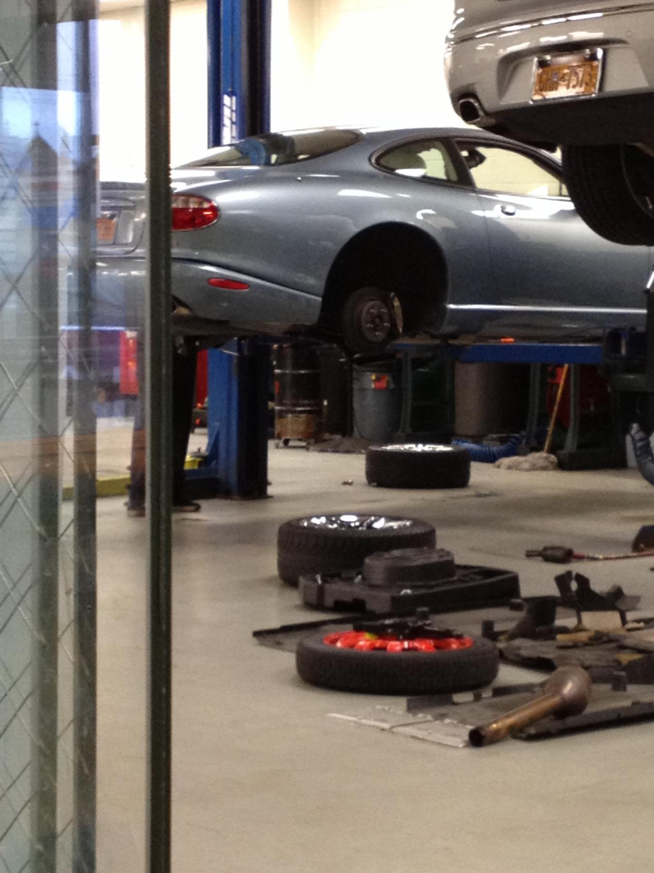

An old proverbial goes - If it ain't broke, don't fix it. Or something to that effect. The service records on my XKR suggest that the car needs break bleed and brake fluid replacement. Since I am not a DYI when it comes to tinkering with cars, I decided to take my Jag to an authorized Jaguar dealer. Today was my appointment at Heritage Jaguar of Freeport (NY). I was told that the process is a one to one and a half hour procedure, so I decided to wait around and look at some new Jags, including the new jet black F-Type that appeals to me, oh, so greatly.
After the service was performed, the bill was paid and my car parked for me - to be picked up at the front yard, I got in and started the ignition. Before placing the J-Gate lever into drive, I gently pressed my right foot on the shiny aluminum break pedal, only to alarmingly finding it sunken all the way to the floor - OY VEY!
Back to the front desk I went, barely holding my contempt. The service man (Bill) verified my observation, then drove the car back to the shop and up on the lift it went again.
After 15 minutes Bill calls me inside the shop and says that he really does not want me to leave the dealership in the condition that the car is currently in, as if I would be suicidal enough to take that chance without him telling me that. He then proceeds to tell me that he is going to give me a rental car (free) and he wants to have his "team" inspect the car to see why the "one half (whatever that means) of the master break cylinder is not working". At this point I am concerned, because I brought the car to him in perfectly working condition, needing preventive service only.
Leaving the car at the dealership, on my way to my office, I was pondering on why many mechanics oppose the idea that changing fluids (break, steering, transmission oil, supercharger oil, etc) is a bad idea. The mechanic who recommended me not to change the break fluid, gave me an example of late model BMWs, saying that if Bimmers require transmission work, the drained oil gets saved, only to be reintroduced back into the system upon the completion of service. As a matter of fact (his "fact", not mine), only antifreeze needs to be changed every 3 years. He also said that the engine oil should be changed every 3000 miles on regular oil and 5000 miles on synthetic.
In the end of the day, one's opinion is nothing but an opinion and could be looked upon from different perspective(s). At this point I am wondering if I should have left things as they were and use the car until something would eventually break, rather than voluntarily expediting that process. I am awaiting for the call from Bill - let's see what happens.
Attached Thumbnails Anyone ever had a brake rotor out of balance?-img_3771.jpg

Heritage Jaguar stood behind their work and, without fuss, fixed the issue, which turned out to be a non-issue after all.
It turned out that it has been a while since their mechanic has done any work on an XKR100 model. He bled the brake lines 3 times and finally got all of the air out of the system. What surprises me the most, however, is that the bothersome steering wheel column vibration is gone and the my car stops on the dime - vibration and drama free - amazing.
Graham is right, when he said that after replacement of brake fluid, the braking improves for some. It did for me.
Iam still puzzled though as to why the vibration went away. No work has been done to the pads or rotors and yet, it feels as if the Jag got an upgrade for both - solid stopping power from fluid change. Perhaps someone may offer an explanation for this.
