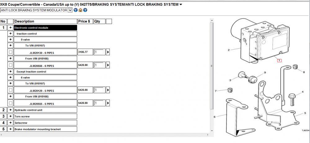

I have found the General Information section of the JTIS, and the ABS system is fully described. A module with nine solenoids has Traction Control, mine has only six.
Thanks again plums for sending me in the right direction. I still dislike navigating the JTIS, but I'm a little better at it now.

I have a fairly early -97 US-spec ( VIN 011xxx ). The switch is marked ASC OFF, and the ABS-module is 6-valve which I know as I have had it out for repair.
Attached Thumbnails ASC/Traction Control-abs.jpg

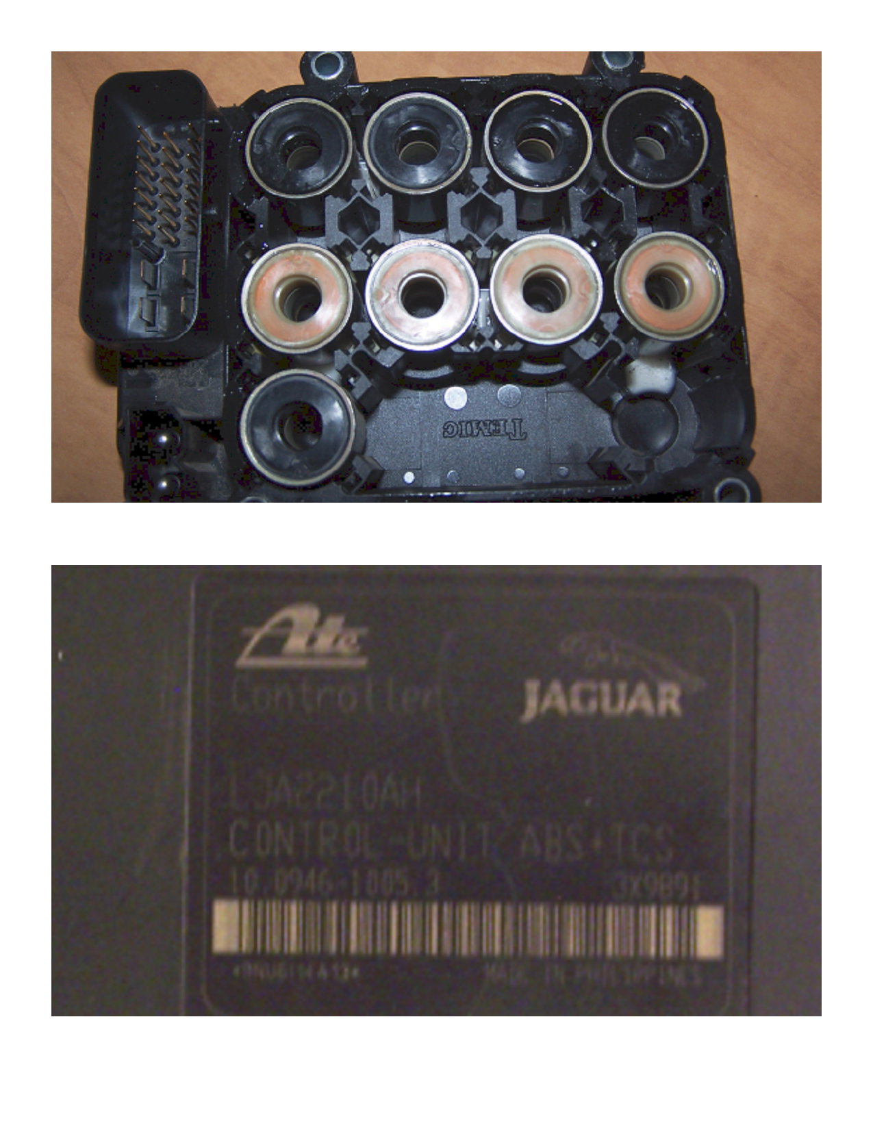

I have an early model '97. I have had my module rebuilt. The module has ABS + TCS on it(see pic)
Attached Thumbnails ASC/Traction Control-abs-control-module1.jpg
