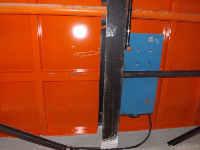

Okay, I promised photos and some video, so here they are. In the first still photo, you will see an electric car up on the third floor on top of an orange steel pallet. The second photo shows the bottom of the pallet which holds the car. It acts as the shelf and transport from the lift on the upper floors. Out of the 17 parking spaces that we have included in this 8 unit apartment, 6 are above grade, 3 on the second floor, 3 on the third floor. There are 2 tandem spaces on the east side of the lift and 1 single space on the west side of the lift on each of two floors. There are 11 spaces on the subterranean floor which are visible in the original posting. A car pulls into the structure on top of a pallet which is on top of the lift. Once the driver (and passengers and pets) exits the room, the garage door closes and the lift takes the car either up or down and automatically places the pallet with the car on it, essentially, in a shelf, where it stays until it is automatically retrieved by waving a small fob in front of a scanner/reader. The next post will have a video of the lift moving.
