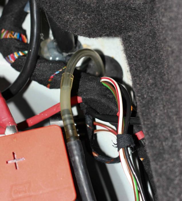

Just aside from what I see is a pretty solid discussion, can someone post a picture of what the venting system looks like? Maybe it is there and I just didn't do what I was supposed to.
Here are some pictures showing the adapter with an Advance Auto Parts AutoCraft battery. My original Jaguar tube was missing, so I just used some vinyl tube from the hardware store. The Jag part number for the tube is DAC77753 and it lists for all of 85 cents at the dealer.

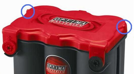

Some AGM batteries are vented to a tube. I found this very interesting quote from an official at Optima on another website:
"Our group 27, 51, 78, 34C, and 31 batteries all have ports for connecting a vent hose. Although people do it anyway, we would never recommend installing an unvented battery in any enclosed space, because there’s a legitimate, albeit unlikely, safety risk involved.
For example, IF there is a voltage regulator failure, and IF the battery is severely overcharged, and IF this goes unnoticed, and IF the battery vents because the internal pressure exceeds the release pressure of the vents, the gasses are both flammable and toxic. This may sound like a lot of “ifs,” but attorneys and engineers get paid to plan for every worst-case scenario. Although our batteries can be mounted in a variety of orientations, we do not recommend mounting them upside down. If anyone has any questions about our batteries, I’ll do my best to answer them."

Attached is a picture of a vented Optima AGM.

I just bought a new battery for my 2000 Jaguar XKR and noticed 2 vent holes on it like the ones in your photo. Do both of them need to be vented or only one?
Yours, Ken
