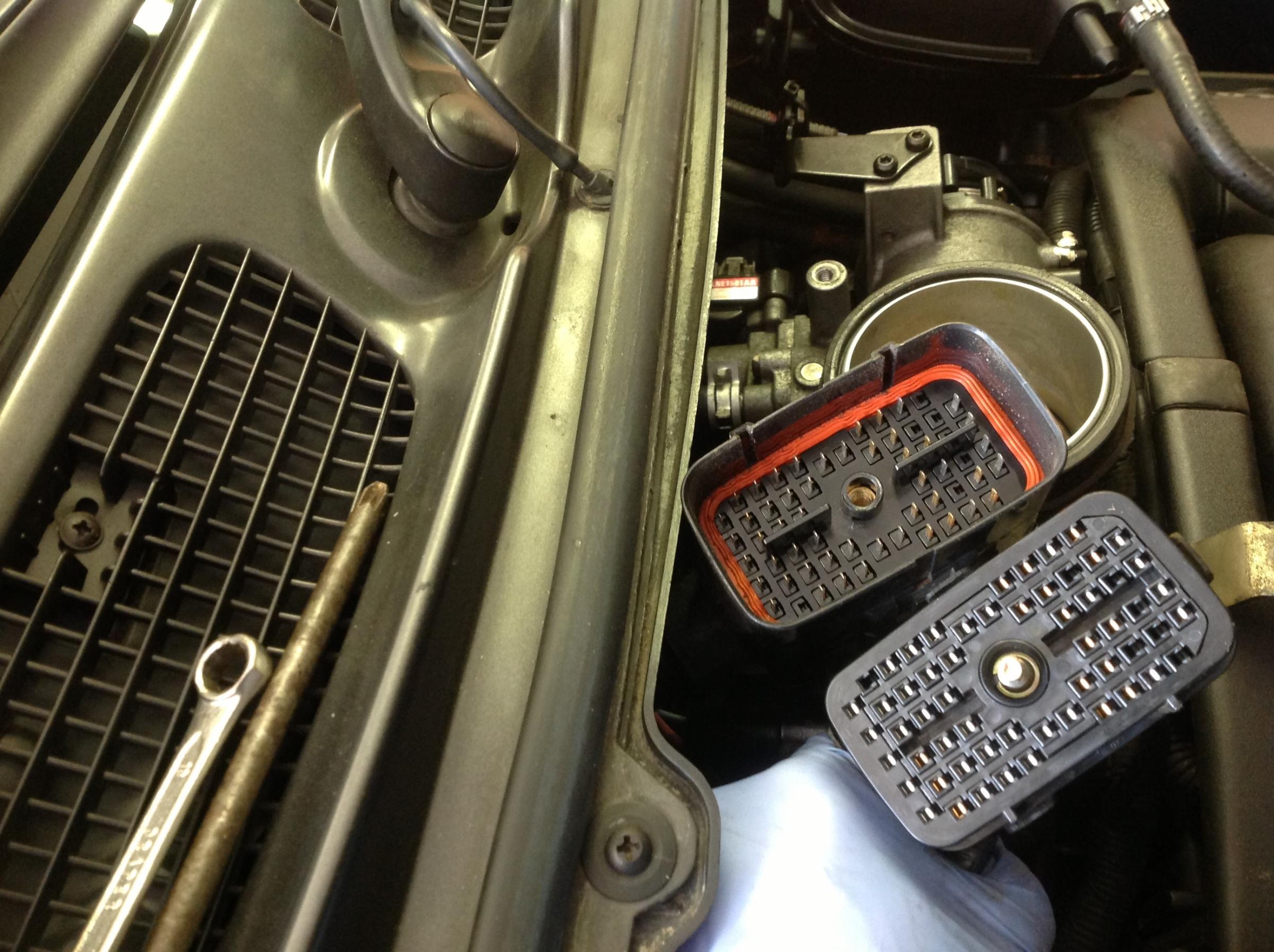

Don't get too excited I just wanted to test how to upload a picture. This is the multi pin plug attached to the bulkhead with a 13mm nut and held together with a 10mm bolt.
Cleaned this and my ABS , ASC and TRAC problems seemed to disappear, (coincidence?) but the dreaded RP remains!
