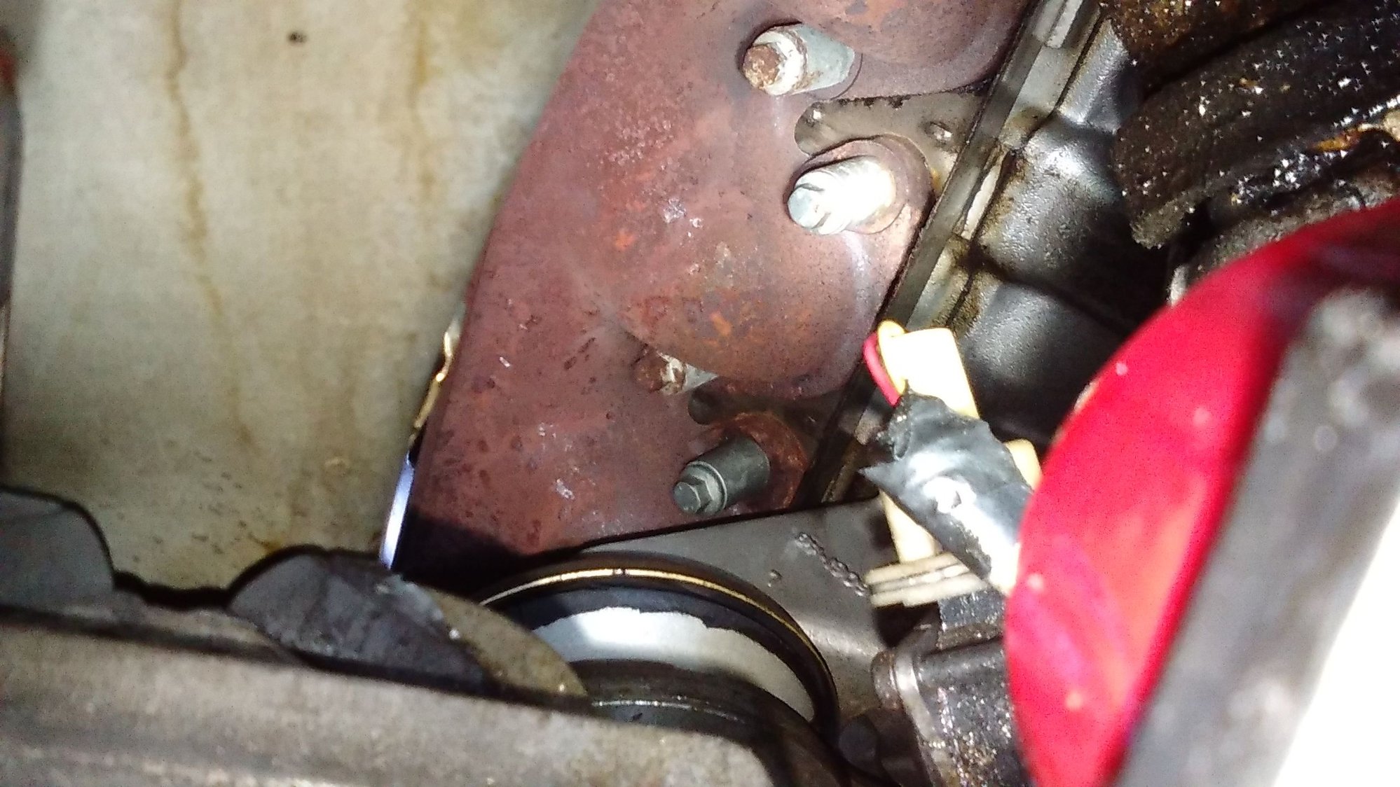

Originally Posted by aode06
I just don't get why this head gasket is only brining oil,and only leaking oil no coolant?????????????The Indy took this picture after power washing the block. In fact, he says the short block looks brand new,the motor mounts brand new,as if it was already replaced with a steel sleeved block, but perhaps jaguar used a cheap composite gaskets, and re-used my head bolts,which is a fatal error. He explains the old bolts stretch and can give false angle to torque specs on the angle torque wrench scale and expand as temps cool and get warm again,causing the head gaskets not to seal properly.

Old Oct 4, 2015 | 06:07 PM
Mikey's Avatar
Joined: Oct 2009
Posts: 11,057
Likes: 2,272
From: Perth Ontario Canada
So you're now saying the engine may have already been swapped for a later steel sleeved engine and there's also a new theory that the dealer went cheap and reused a few bolts.

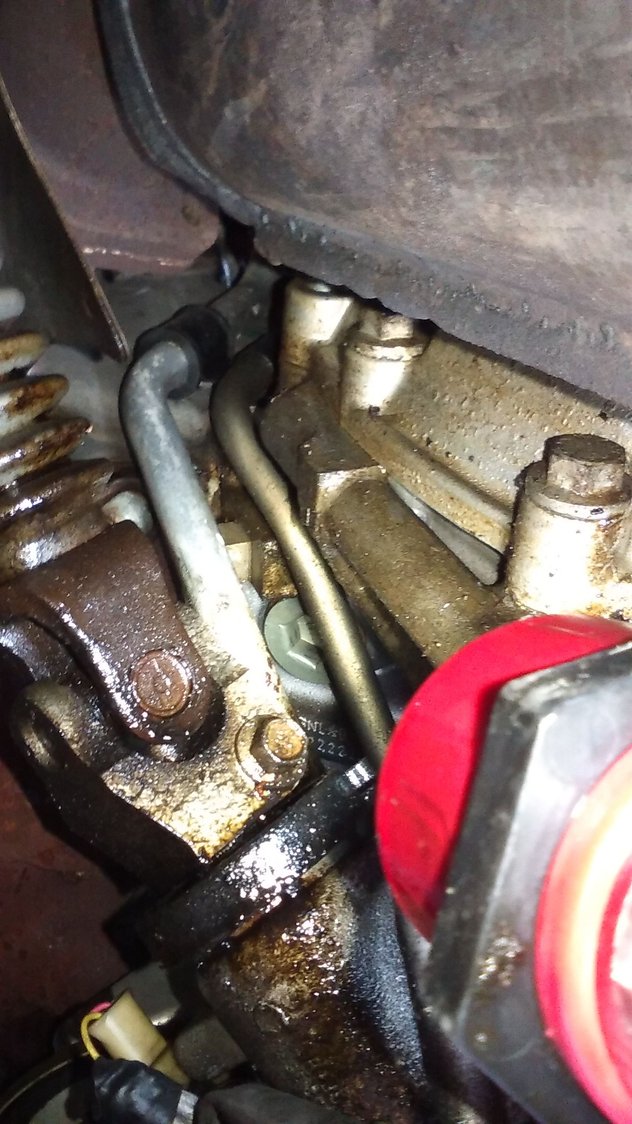

From: Cincinnati,Ohio USA
in this picture, you can see the short block is new,the motor mounts are new,the block drain plugs are also new.

  #34
Mikey's Avatar
Joined: Oct 2009
Posts: 11,057
Likes: 2,272
I guess I'm not seeing what you are but your latest theory is that someone recently swapped in a different engine?

In the picture, isn't that duct tape wound round the wiring too?? Someone's been there before....
