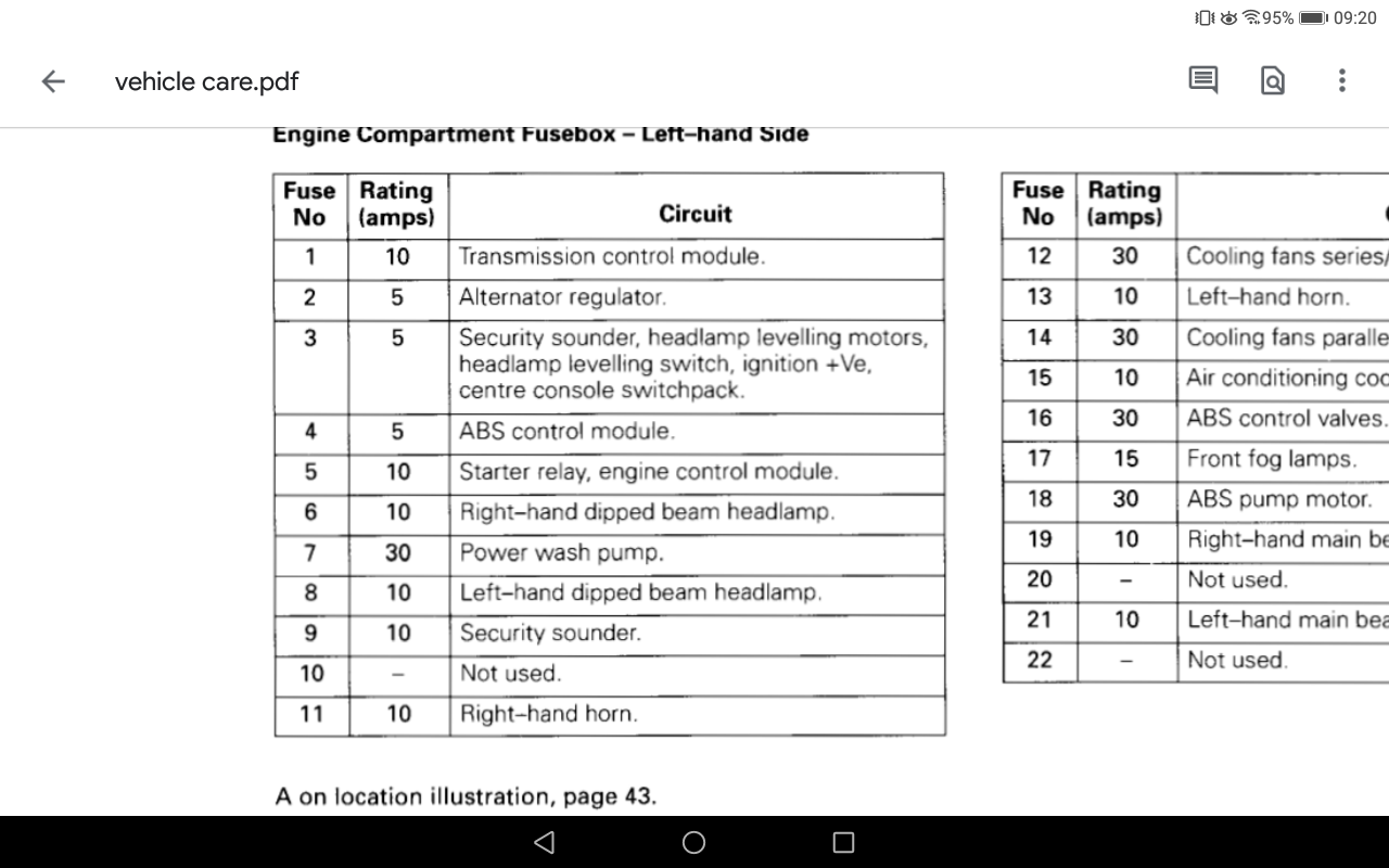

Hi
number 3 fuse, 5 amps located in the engine compartment left hand side
I replace it but when I switch the key on ignition position the fuse immediately blowns
any idea about where start to check?
Thanks
Jacopo
Old Nov 8, 2020 | 04:40 AM
jacopost's Avatar
Joined: Nov 2020
Posts: 38
Likes: 11
From: Lake Maggiore, Italy
sorry guys
as written in other threads the problem the security sounder
disconnected and the fuse doesn't blow!!
thanks
