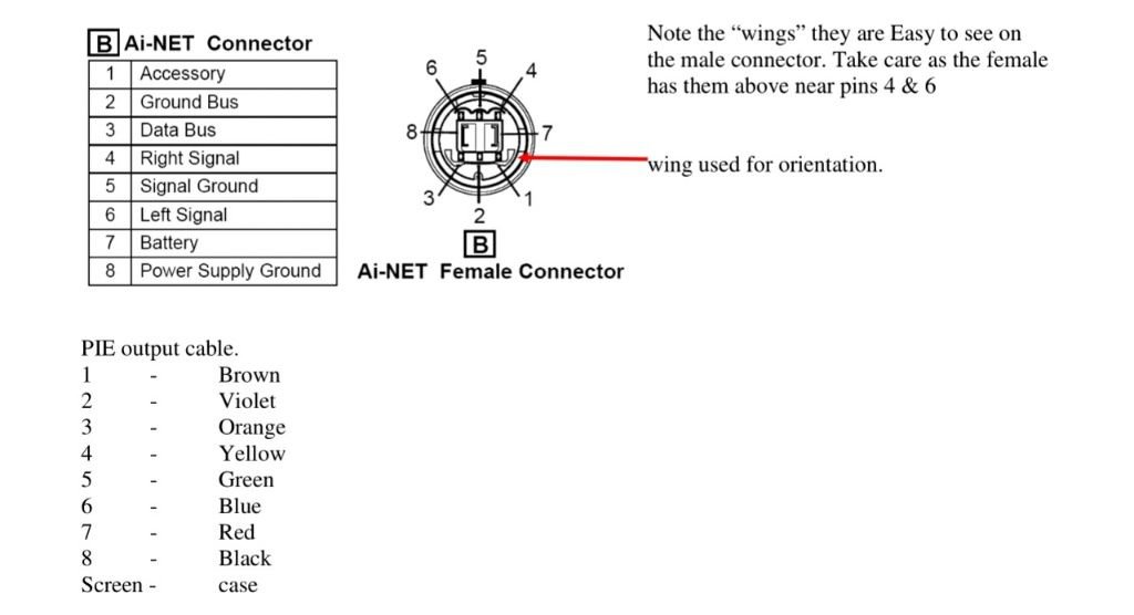

If you just want bluetooth music, then a simple solution would be to buy a Bluetooth audio streamer and connect that to the audio L-R connections from the CD player in the boot. Something like this one:-
http://amzn.eu/7HPoEOZ
You would lose the ability to play CDs and instead get Bluetooth when you select CD on the head unit. To do this you need to splice into the audio lines in the cable that goes from the CD unit, leaving the other connections intact (so the head unit can still "see" the CD player). A car audio installer should be able to do it.
The cable you need to splice into:-
Pin out for the connector:-
