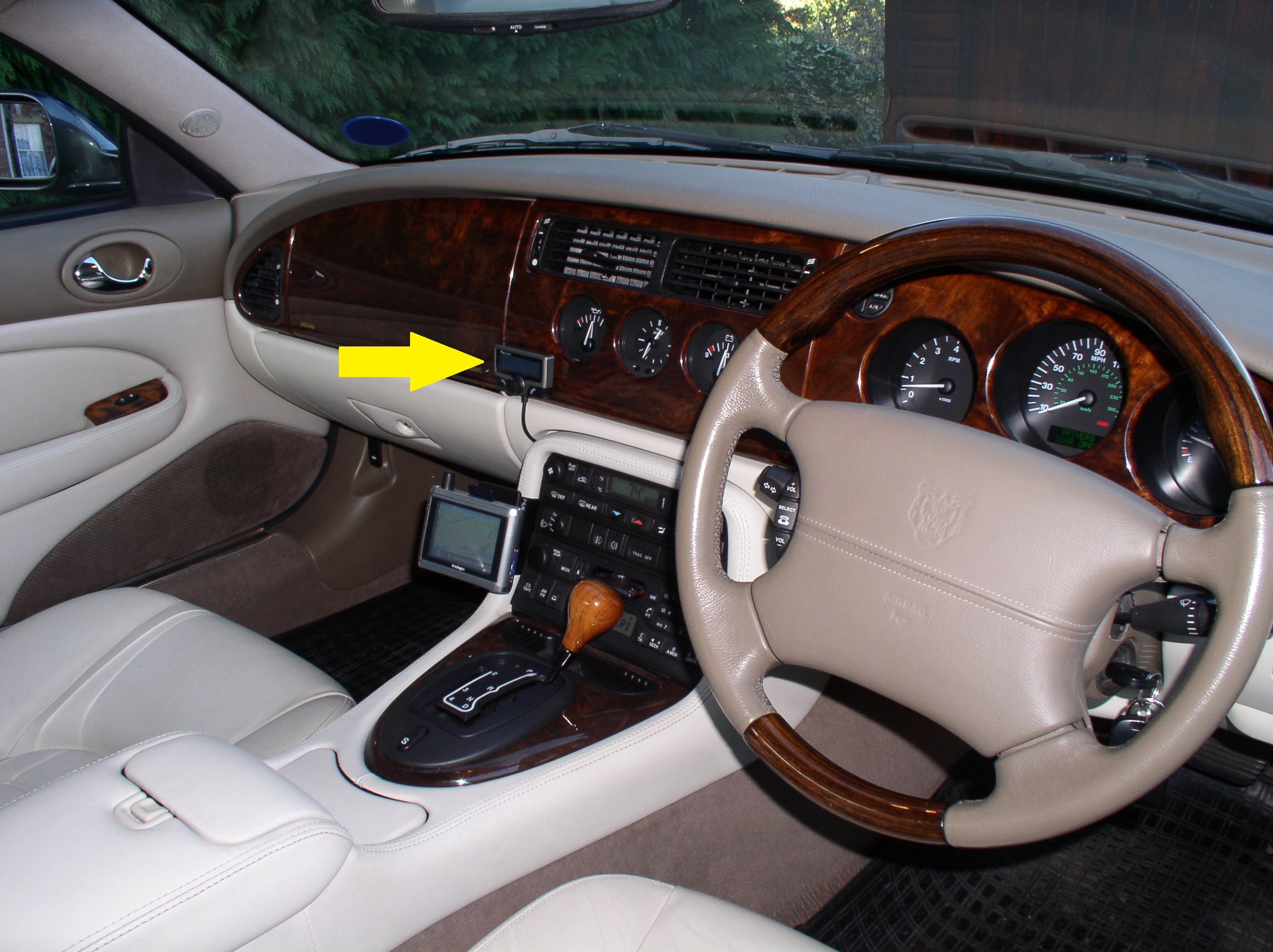

My 2001 XK8 Coupe was the only Jaguar I've had recently that didn't have factory OE telephone installation.
After looking at several options, I fitted Parrot CK3100.
If I had another Jaguar without factory Bluetooth, this would be my choice. Pairs to multiple phones (the factory BT to 2005 only pairs to one phone at a time) and connects automatically when the ignition is switched on.
