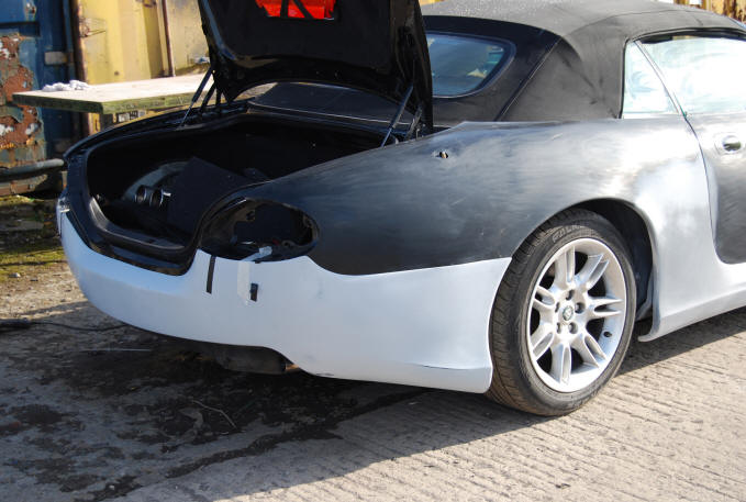

Car in bodyshop, got called to a problem they have. They had the boot/trunk open to try and adjust alignment, did not adjust anything but when they closed the boot/trunk it will not now open. Cant use the manual key method as the new rear bumper covers the hole between the XK. the car locks and unlocks O.K. with the fob, only difference now is that when I lock the car it gives a beep but no flash of the indicators, where as before when I locked the car I got no beep but the indicators flashed. Did a search and came up with a thread that said there is a red lever next to the lock mechanism that if moved locks the boot/trunk permanantly, hope they did not move this. Anyone got any idea how to unlock the boot/trunk without ripping the rear end apart?

The new rear bumper is the Granley design rear end which wraps around the rear and is bonded into place covering the hole for manually locking/unlocking the boot/trunk. The new bumper sits further away from the body of the car so even if a hole was drilled the shaft of the key would not even reach into the lock. The fact that using the fob has a different beep/flash sequence to before makes me wonder if some sort of valet inhibit has been activated or if the battery voltage is low there is not enough power to release the solioid holding the lid down.

The new rear bumper is the Granley design rear end which wraps around the rear and is bonded into place covering the hole for manually locking/unlocking the boot/trunk.....................

Graham that is the bumper I have fitted, not easy to see but it does sit away from the body of the car where the key hole is, and the shaft of the key would not be long enough to reach into the lock.
